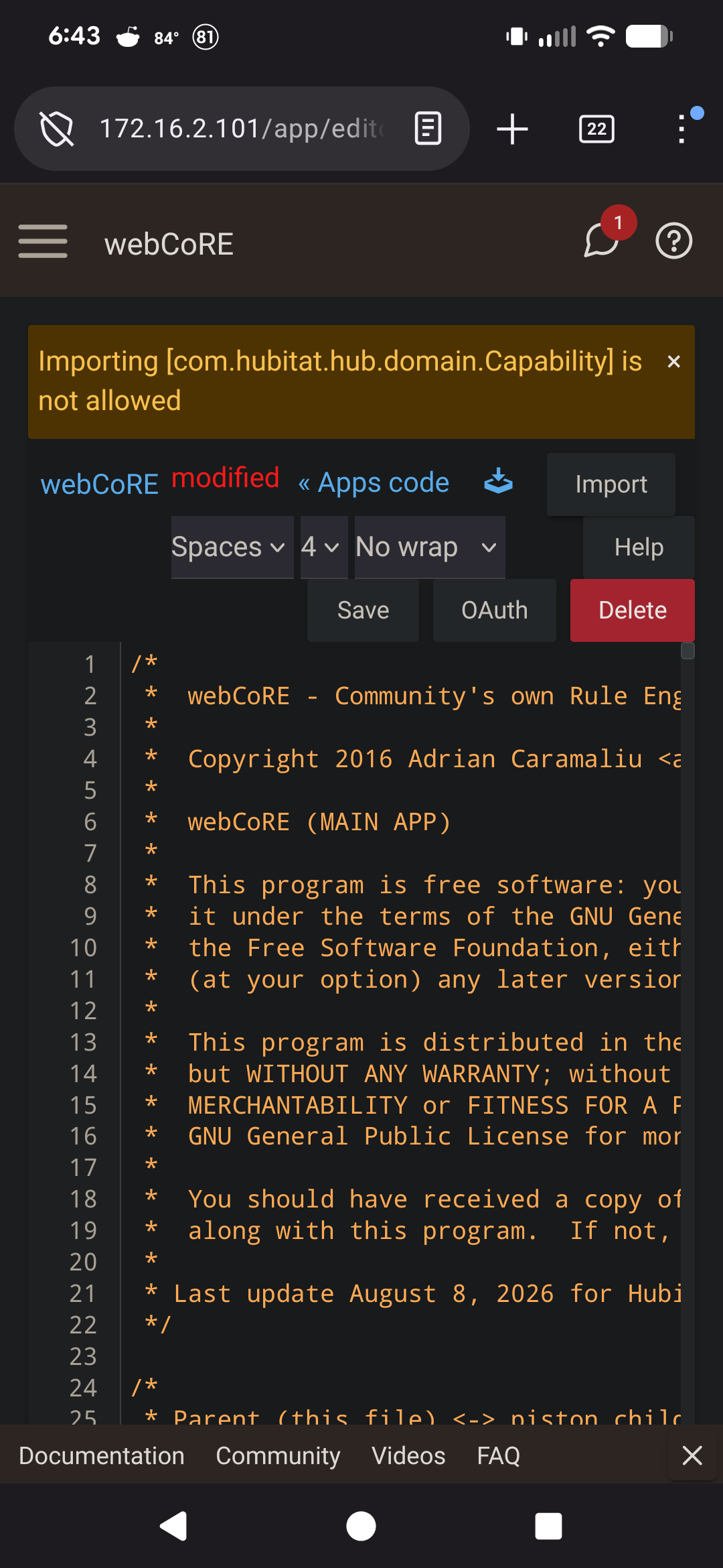

I just tried moments ago with a manual update and got this:
Any suggestions?
What version of FW are you on?
@gopher.ny ?
Something quite old (but still specifically unknown), according to another topic they started for the same problem. :slight_smile:

It's been a while since I manually updated webcore in my C7. Can anyone provide instructions and links as I've forgotten the order of updating and where to get the updates from.
Determine first if you installed the built-in app, or if you used the community source. You could have copy-pasted in the code directly, pulled it from a git repository, or used Package Manager, if it is the community version.
If you have Package Manager and it shows installed there, update from Package Manager. If you have the built-in, you should be on the latest version if you are on the latest platform release.
In post #1 you will find the instructions and links for a manual refresh.
Open each link Github for WebCore, Piston, select RAW and copy/paste onto the matching code on Devices code. Make sure you have the Dev switch (Show advanced/developer options) on in Settings so you can see this tab. Then just Save and it will recompile the new code.
If you have a C7 and the HPM install I believe and update will timeout.

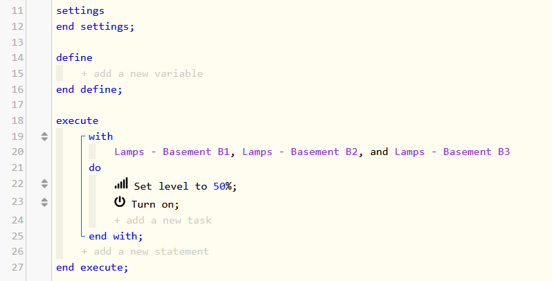

I have a situation that has been going on for at least a year where devices, such as lamps lose commands such as on/off. Below is an example. I have three bulbs I wan to turn on. When the piston executes it will turn on the first two but fail to turn on the third device as the end of the list.
I have using full logs tracking what the piston is doing and from the log's standpoint there are no errors. Looking at the event of the lamp that didn't turn on, I see a command-on being issued by WebCoRE but alas, no light.
This would seem to me the issue is not with WebCoRE but a failure of the hub to follow through but, if I edit the piston and then save it, the piston will turn on all three lamps as it's supposed too.
I have done a soft reset thinking I have database contamination but that doesn't correct the issue.
I'm running the stand alone version and on the latest version however the situation I'm laying out here has been at least a year, probably more.
Has anyone ever run across this problem? It happens so rarely maybe it gets missed? Anyway, just putting it out there to see if i'm the only one.

Yes. It looks like WebCoRE is doing everything correctly. The only reason I question WebCoRE is the problem resolves if I do a edit/save. It acts like some type of data contamination that gets corrected when the piston gets saved. Does webCoRE have it's own database, or is it part of the hub itself? I was thinking if I backup all my pistons, then delete and do a restore whether that would flush things out.
ensure you are on the latest webCoRE. I'm not aware of issues in the latest.
I am. This isn't a new thing. Every once in awhile I find this kind of issue and I edit/save and move on. I may try and covert over to the internal webCoRE but I just haven't found the courage to do so.... yet.
One thing I do when things like this happen is turn off the pistons smart state option and force it to do the on/off all the time.
I had one bulb last week that refused to work in the piston but was fine in the devices tab.
Turned off Command Optimization and Voila, the synced up and now works again.
