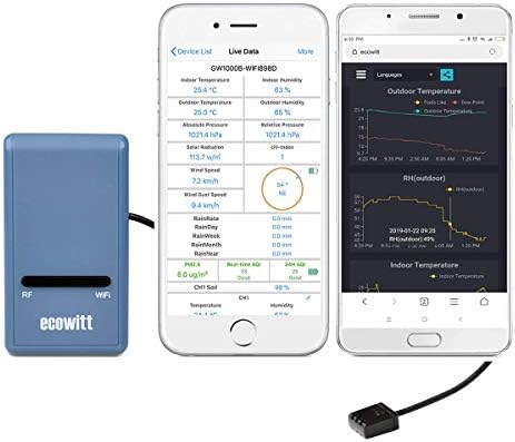

I think some people on wx-forum are using the ecowitt gw-1000 for local weather information combined with different sensors.

The EcoWitt PWS are the same sensor array that Ambient Weather sells. Their EcoWitt GW-1000 is very easy to integrate with external systems. The combination of their PWS and GW-1000 provides a completely local PWS setup.
You could also go with Ambient Weather with their ObserverIP which is the older local PWS receiver (pre GW-1000) which is local but you have to scrape the data as it only provide a local web page for viewing the data. If scraping the system runs out of memory if polled too frequently and crashes.
A very popular setup is WeeWX and it supports multiple Sensor arrays. The WeatherFlow system data is also available local without internet required.
For Hubitat integration none of these are "out of the box" though and will require development.
