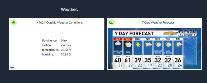

Weather Data Tile Using OpenWeatherMap
Thank you soooo much !!! It is now added to my Dashboard. See below

FYI. I did find the gallery of images using the URL you provided.
Thank you again so much! How did you even know to go there? Also would still love to know how to determine the links of other type of dynamic graphics in the future so that I can create virtual devices for them to possibly add them to the Dashboard.

anyway here is another one
https://kubrick.htvapps.com/htv-prod/images/dynamic/wbal/7day-today.jpg
which came from here
WBAL Weather: 7-Day Forecast, Forecast Maps
i hope this helps
Looking at your questions, again, not all weather pages have images displayed. They use API or jscript or some type of script to display the weather. You just need to browse around and find a weather page (locals news is best) and hope they have an image displayed that you can pull from.
This is perfect. This does pull the process all together for me and I finally do understand.
