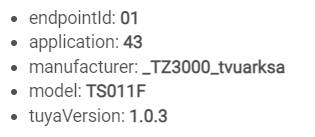

I've just received a zigbee shutoff valve and it is working OK using your 'Tuya Zigbee Valve' driver. Thanks for a great driver.
Just for info here is the data field information.
