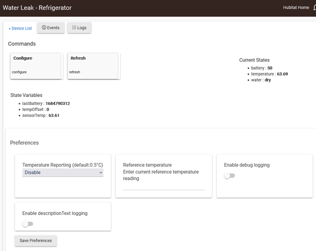

I am getting temperature events from my water leak sensors every minute. I have 11 of them (IM6001-WLP01 Water Leak Sensor Zigbee) and they all do this despite turning off the temperature reporting. Are these events flooding my hub and should I seek a solution?

Without re-pairing: activate the water leak sensor (press the device button if there is such one, or wet the sensor) at the same time, when you click on the âSave preferencesâ button.
This seems to have stopped the per minute temperature update. Why?

Please post a screenshot of the Device Details - Data section (need the model and the manufacturer)

Regardless, disabling the temperature reporting should actually disable the event from being sent by the device. Now I am not quite sure whether my driver actually reconfigures the reporting interval, or just hides the reports. I will have a look when I have the time.
