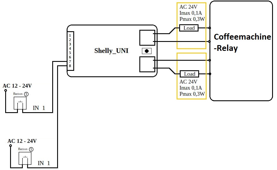

a quick question from my side. I'm playing around with my coffee machine. Right now, If managed to get the shelly uni onto the coffee machine and turn it on, which was pretty easy. The old switch stayed in place, so I can turn it on and off using the shelly or the original button. The only problem I have right now, is when I use the button, the is no updated status in the app or my HE. To get this going, I was thinking about connecting the button onto the shelly. When I got it right, I can use position 7 & 8 to switch the potential free relays (see picture). So connecting everything this way should give me the status update. So far right? Two more things which are bothering me right now are:
Will this work offline? For example, when I move houses, will the coffee machine work, even if I haven't hooked everything to my network.
The coffee machine has an auto off function. Will I get the status update or will the UNI always display "on". I know, there is auto-off for all the shelly devices, but I want to preserve the offline functionality, because for me a good smart device is adding options and not replacing them.
That all sounds right to me. Some of the functionality in your two points (offline functionality and auto-off status being reflected) will depend on the specific behavior and electronics of the coffee machine. So, my advice would be to just try it out.
