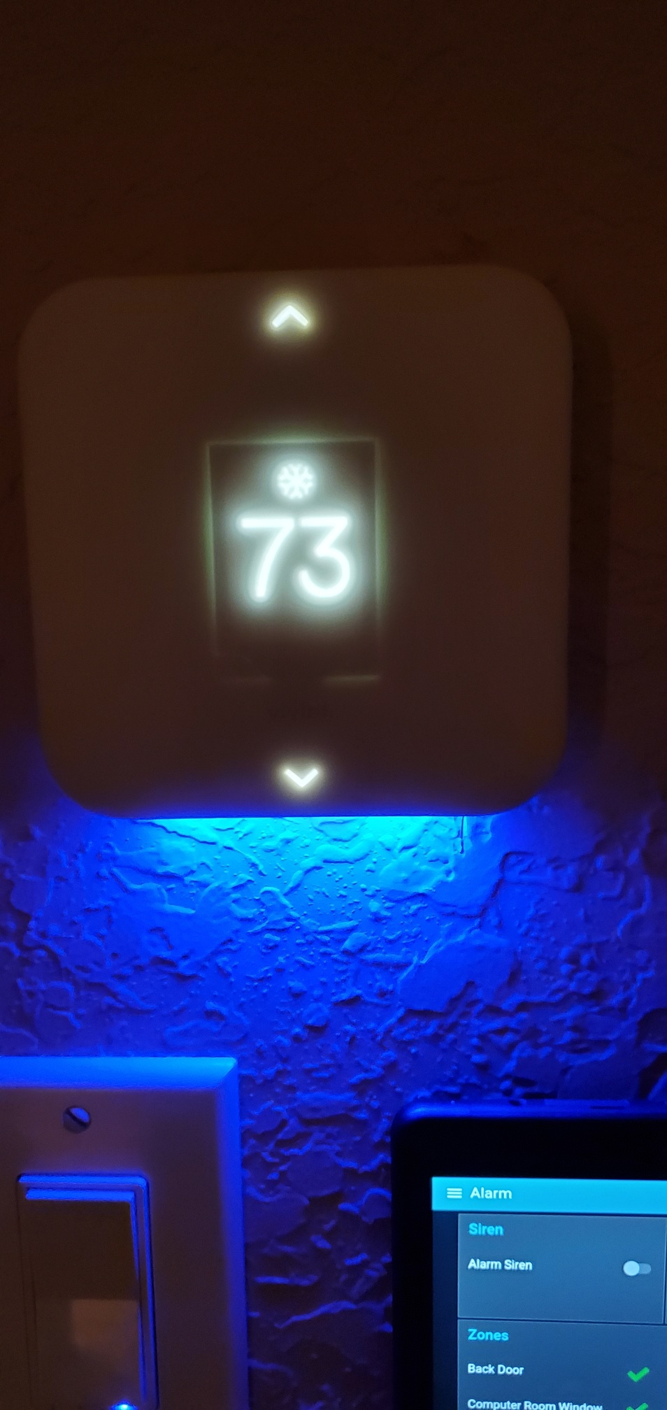

I don't know. For the thermostat in my bedroom I got yelled at for turning it on, as my wife walked by it in the middle of the night and it scared her when it came on. Lol. It's a bit bright in a dark room.
Bad picture of it in the dark:
If you pull the c wire the ct200 will act as a zwave repater. Assuming this project works i will be pulling that wire for that reason.
Yikes! That is bright!!
Yes, when powered it acts as a repeater.
