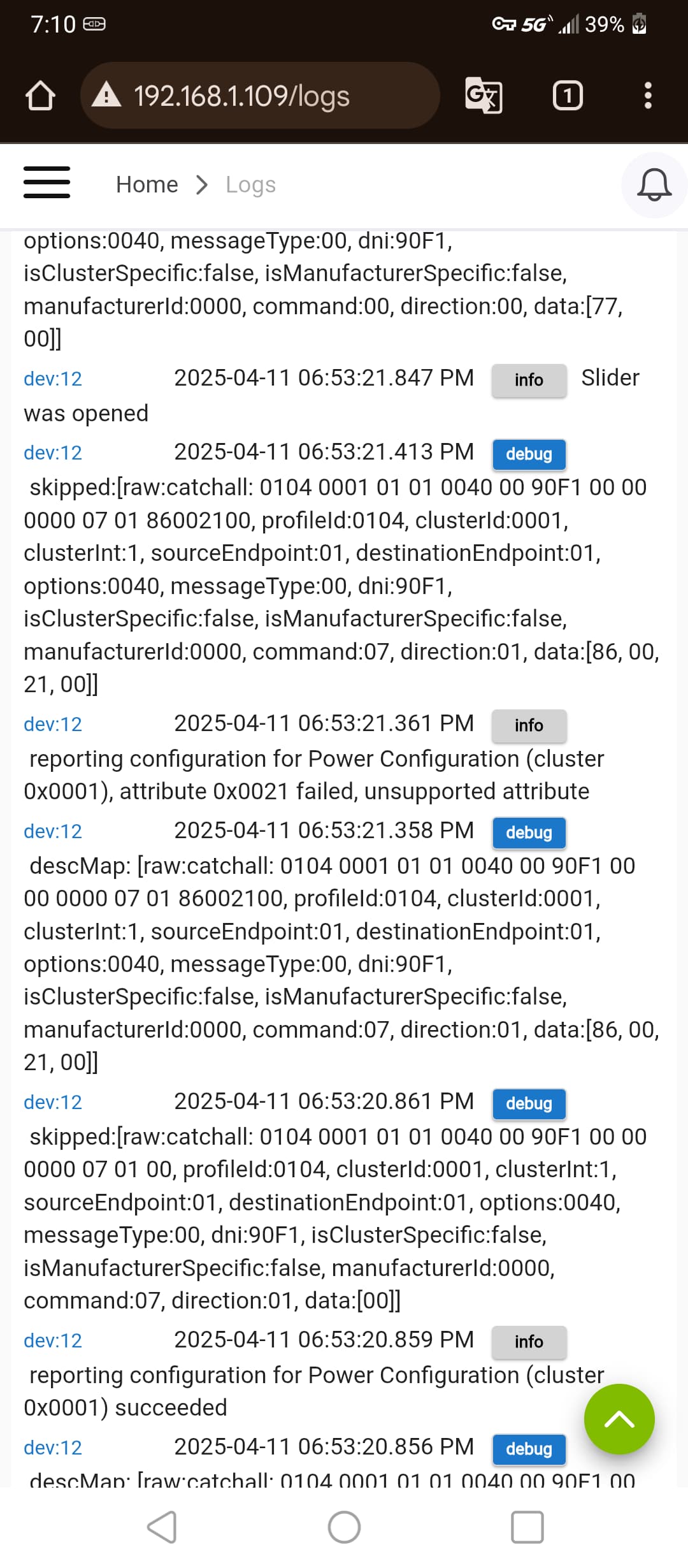

I have some 370 sma that also are not
Reporting temp. Only on initial setup. Repairing doesnt help . Has to be a driver config issue. Anyone have a better driver. Same fw as 370 above. .25 doesnt work. Trying every 5 minutes
I think this failure during config may have something to do with it. 5 and 10 minute also not working.
@mike.maxwell
I'm confused, this device doesn't report power, battery sure but not power.
What driver is being used that is trying to change the power config?
Finally got one of the two going. The key seemed to be continually trying to save preferences with debugging on till i see them take..The other one refuses to try to set anything. at least nothing is coming out with debugging on
My thoughts are that the hub is not saving the preferences/settings.until the next time the device wakes up and phones home. May have to try immediately after inserting battery.
Your generic zigbee contact sensor. Which was automatically picked up
