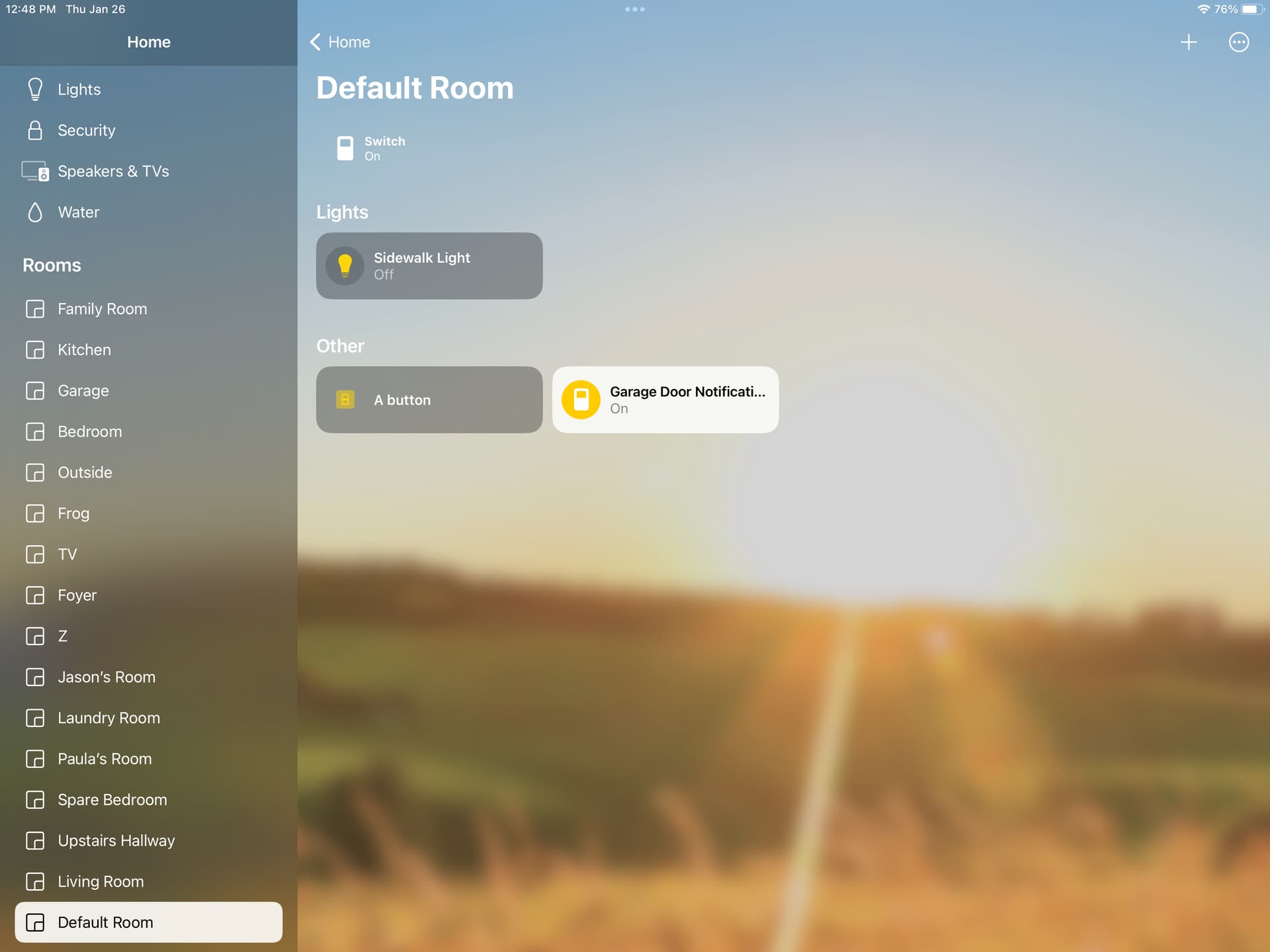

For me, the switch/button moved to Default Room once it became a button.
The tricky part here, Default room did not appear on the default page of the Home app, so the button looked nowhere to be found. I had to click on the triple dot menu button and find Default room there. Once selected, it showed the button and I could click/hold, go to Accessory details, and reassign the room.
I’ve finally found where my buttons are - not in a Default room, but in one that I have named ‘Test room’. This was the first room that I have created in the Home app, obviously it becomes the default one.
