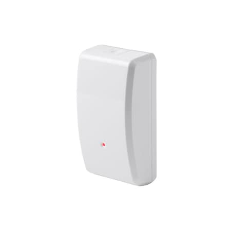

I have a Momoprice Shock sensor on my family room patio door. It works well, battery last forever and no problem on the zwave channel. It is Zwave Plus and has KFR-ZS5101US-5 on the back.

I’m not finding this for sale on either the monoprice website or Amazon.
