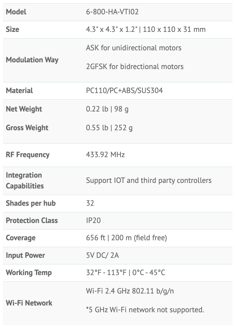

ETA: Just looked up the VTI Re-Lion Hub - it looks like the communication between the shades and the hub might be 2 way, and is via 433.92 RF. Then the Hub communicates to the Vertilux cloud via 2.4 GHz wifi.

Remote doesn't say anywhere that I can get to without taking it apart. However, like you stated the spec says it's 433.92 RF. (I'm sure this is what you saw too)
