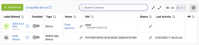

I purchased a hub from Amazon using a camelcamelcamel alert for when it dipped below a certain price. Didn't realize it was a used hub, but the seller has declined a refund because its more than 30 days, and Habitat support requests have gone ignored and unanswered, as has an email request to original user. Is there anyone in the community that knows how to make this hub useful without having admin account? Some screenshots attached below.

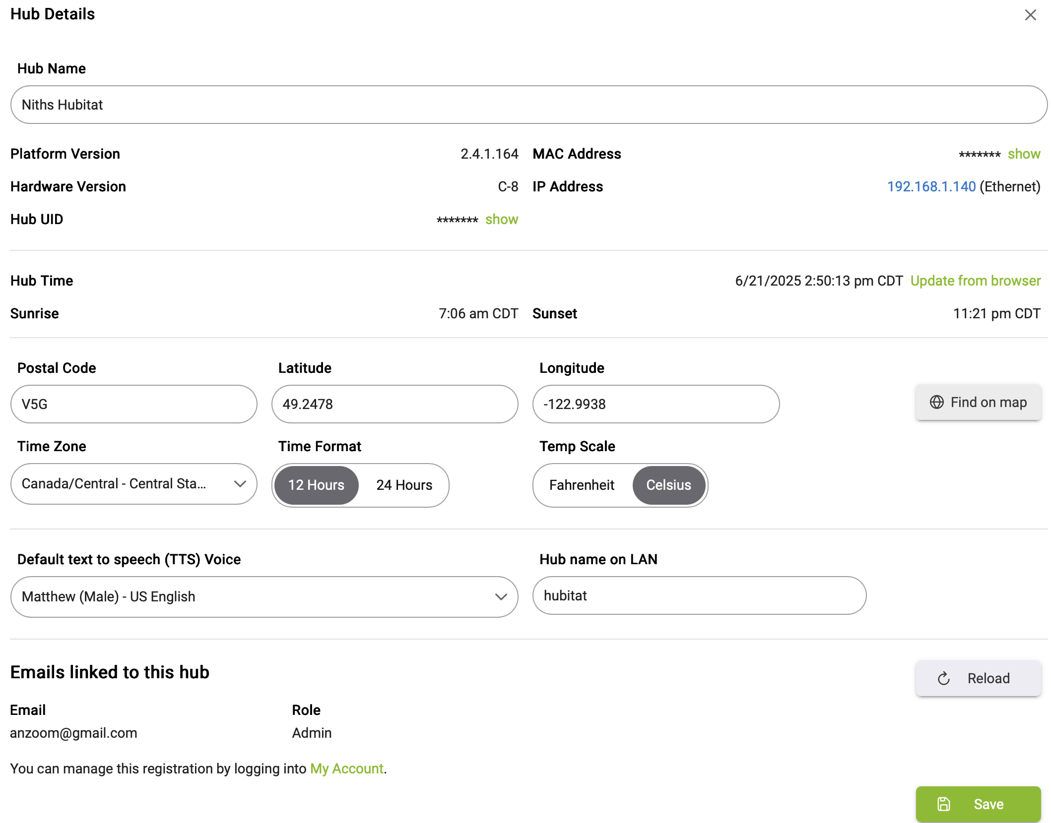

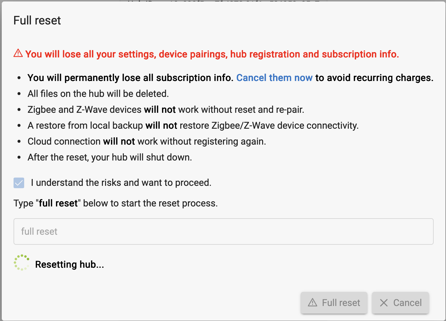

You can do a Full Reset. Go to the Diagnostic Tool (http://<your_hub_ip>:8081) and look for Full Reset.

Any other suggestions would be great, I will look into @bravenel full reset suggestion, but in previous posts, Reddits, and other forums I've read, step one was to deregister the hub. I cannot do that since I do not have access to the admin account.
A full reset should also deregister the hub.
Let us know if that doesn’t do it.
That's what Full Reset does, along with erasing any devices paired to the radios, resetting the radios. It will return the hub to a like-new state.
Thank you, @bravenel and @marktheknife that concludes a 10 month saga trying to get started with Hubitat. Appreciate the quick replies.

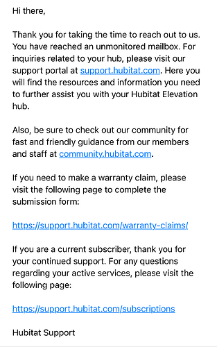

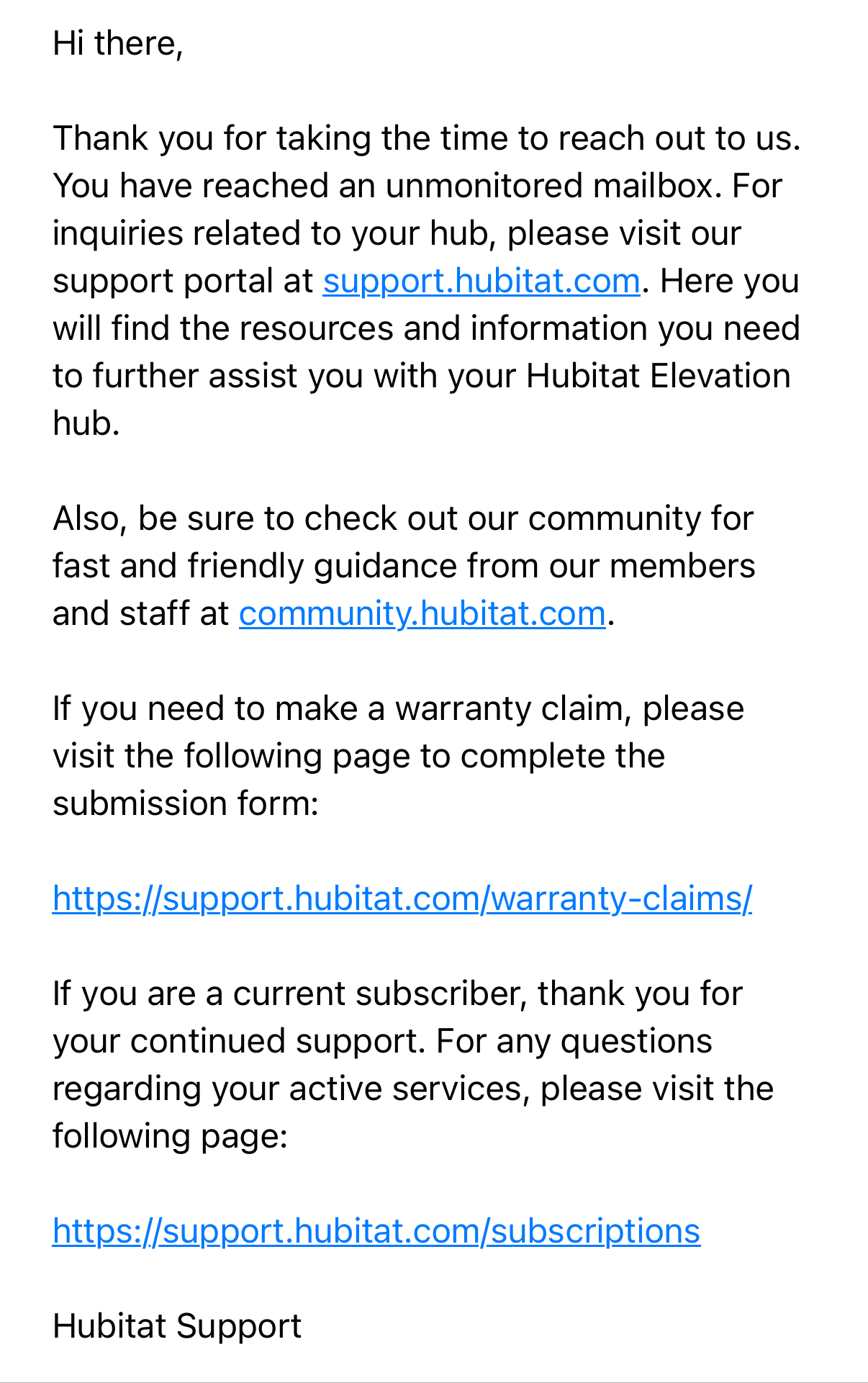

FYI, there’s no support email address.
Well, there is and there isn’t
support@hubitat.com exists, but sending an email to that address prompts an auto-response that advises users the inbox is unmonitored, with instructions on how to access support web forms as well as this discourse community.
I assumed this was an email form, especially since it asks for an email address.

AFAIK submissions to that web form are monitored, so I’m not sure why you didn’t see a response.
Regardless, I’m glad to hear you were able to get things sorted out very quickly once you posted here in the forum!
It’s very rare for support requests to go unanswered for an extended period. As a general rule, if you don’t receive a response within 3 business days, we strongly recommend checking your spam or junk folder and following up with us.
While missing responses from our support team are uncommon, we’ve seen occasional issues—particularly with private email servers—that may block our messages before they even reach your inbox.
In your case, I checked your account, and we received your message on April 27th. A response with a proposed solution was sent on April 29th.
