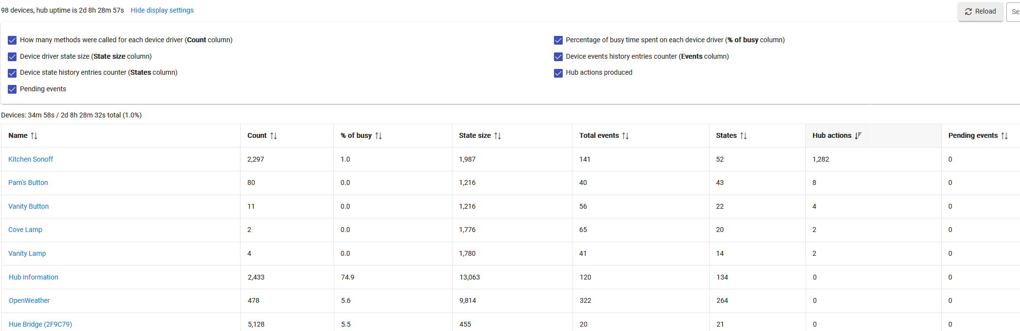

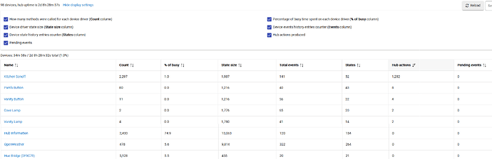

I was running them with @kkossev wonderful drivers but the issue persisted. I am running the presence with it right now. But that device somehow seems to go haywire on occasion and I just repair it and away we go. The last 2 times it happened this device managed to generate a ridiculous number of Hub Actions. I cannot find my other screen shot but it came in at over 1200 Hub Actions. I don't recall how long it was up.

Another edit: I found the other screen shot. It was up for 2 days to hit that. I should also point out that this only happened recently after removing the other Sonoff repeating devices when trying to track down the latest infrequent reboots. I did not see anything like that during the months of trouble shooting.
