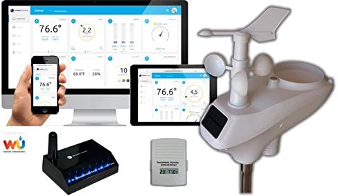

I purchased this one:
The cool feature is that I can register it to WeatherUnderground and it adds to their forecasting fabric. This is great as I'm in a bit of a microclimate. The not-so-cool feature is that it needs to register with WeatherUnderground and thus there is a cloud connection involved with HU.
I would think that in your use-case, you'd want some prediction of wind speed so that you could take care of your umbrella prior to the wind actually launching your umbrella into the neighbors yard. This may connect to using a neighbor's weather station and save you some money there.
I’m in the UK and just bought one for the very same reasons.
Took 10mins to setup and about 30 mins before I was getting good data from WU.
It doesn’t have a console or anything but as I only wanted to get it to report to WU it was perfect for me
