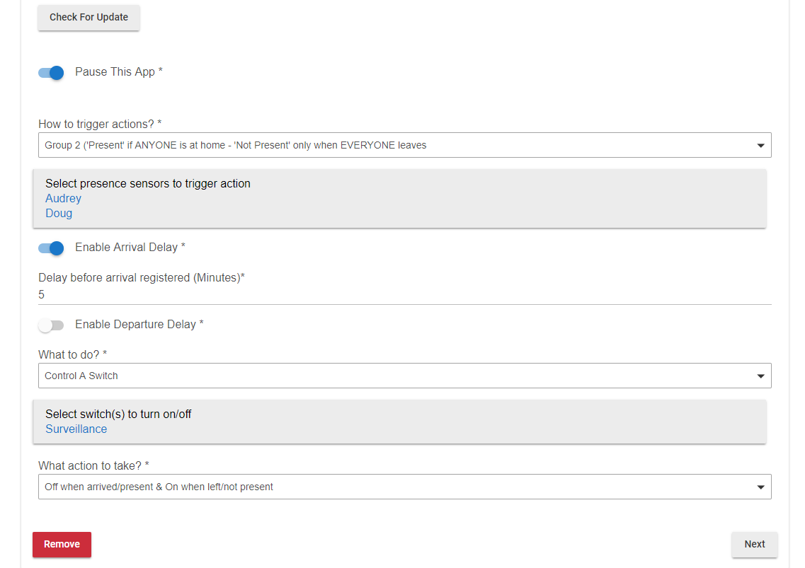

It seems that the Group 2 trigger actions are not working as I think they're supposed to.
Whenever I set this up, every time any of us leaves, the action is triggered.
For example the following rule. If either presence sensors leave, the switch is turned on. Am I missing something? I have more than one rule setup this way, they all behave the same.
thats incorrect
its says present if anyone is home not present if EVERYONE leaves
so for your switch to turn ON in this case you both have to leave.

Curious, so it's just me?
he suggested that it would trigger if only one of them left?
have you used this exact child app before and changed the switching (group type) to be something different to what it was? If so delete and recreate it, I had a issue when i did that.
Ya, that's what I'm saying, it triggers when anyone leaves even if someone in the list is still home.
Man, I don't know, maybe. I'll try that.
sorry my bad i thought you expected it to do that and it wasn't, not it was doing that and you didn't want it to.
this is exactly what happened to me when i changed the group type from group 1.
Recreate the app and your be fine
Yep, I’d be suggesting recreating it and retesting also .
I’m pretty sure I had to do the same when I first set it up and it’s been working great for at least 4 months.
Thanks, I've done that now. We'll see...
