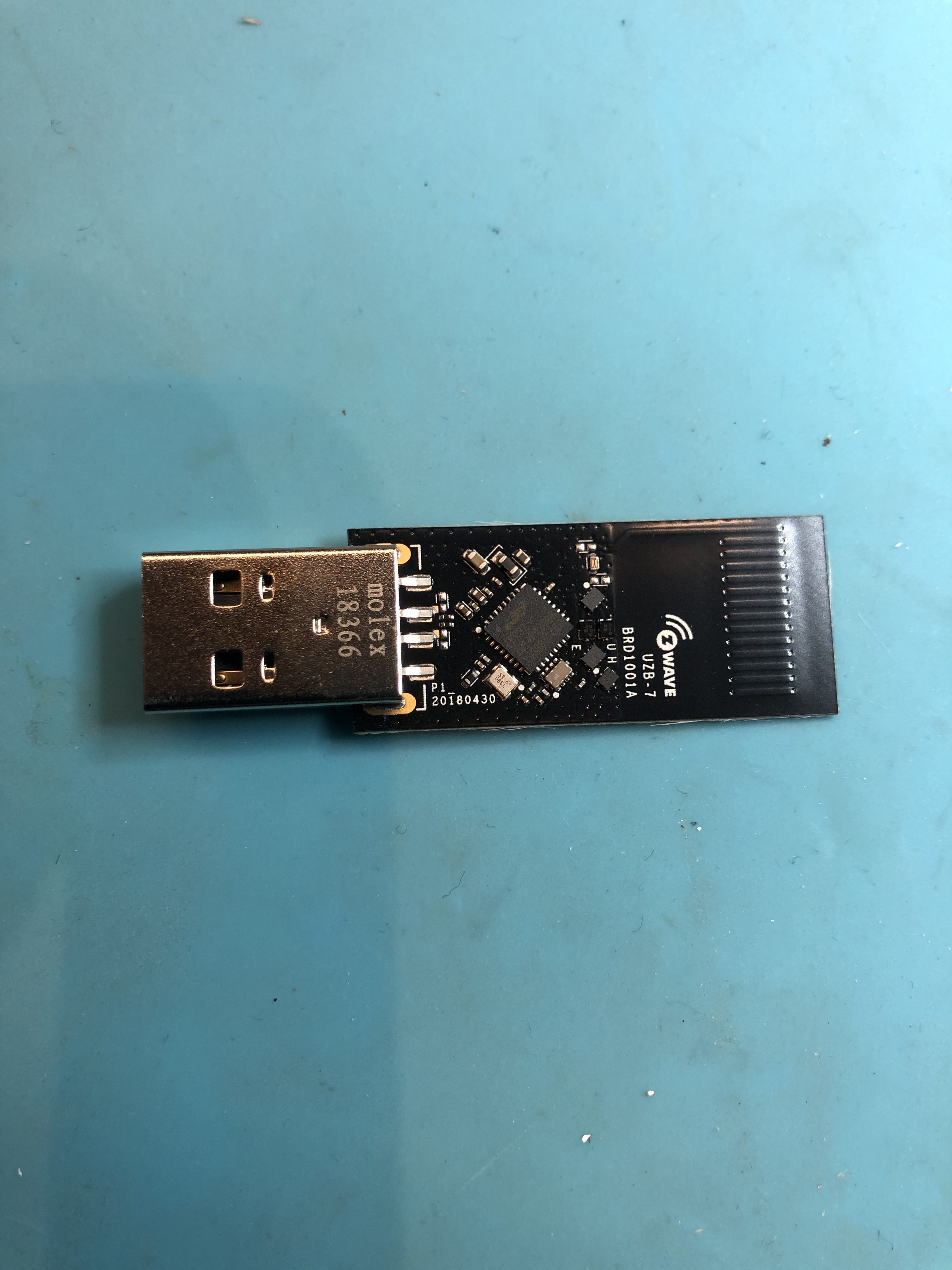

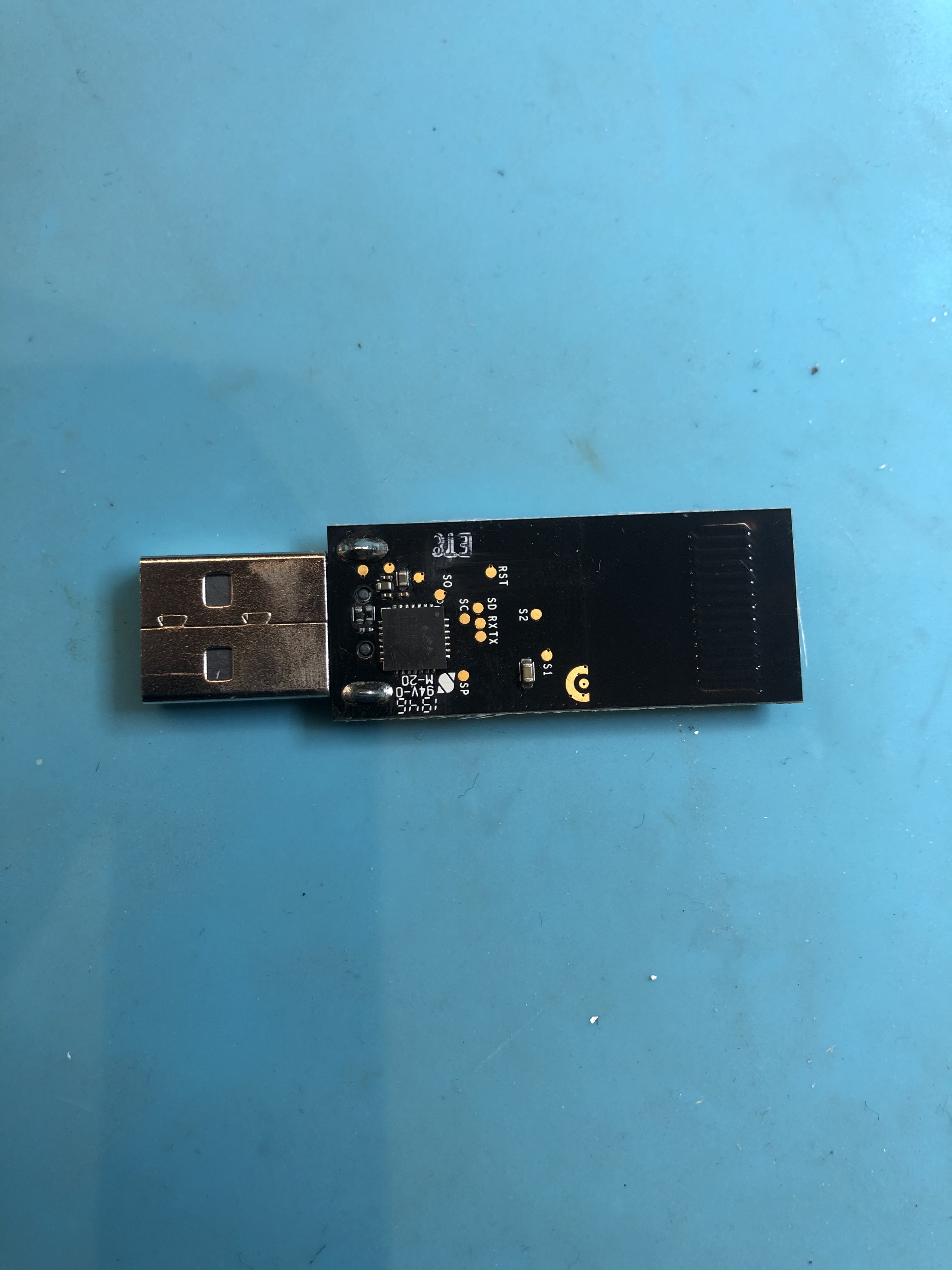

Opened the usb but no pins to move
It's probably handled in software. Take some pics... Curious to see what it looks like inside.

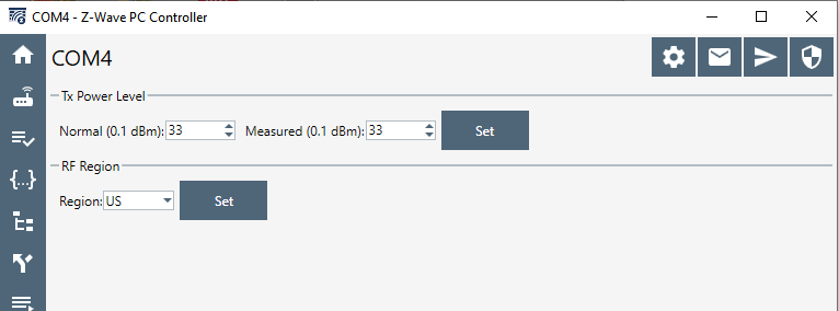

I don’t have it open right now, but I believe the SiLabs Simplicity Studio v5 program (or the PC Controller software) lets you set the frequency of the 700 series chip.
I'm poking around in PC Controller now to see if I can find it.

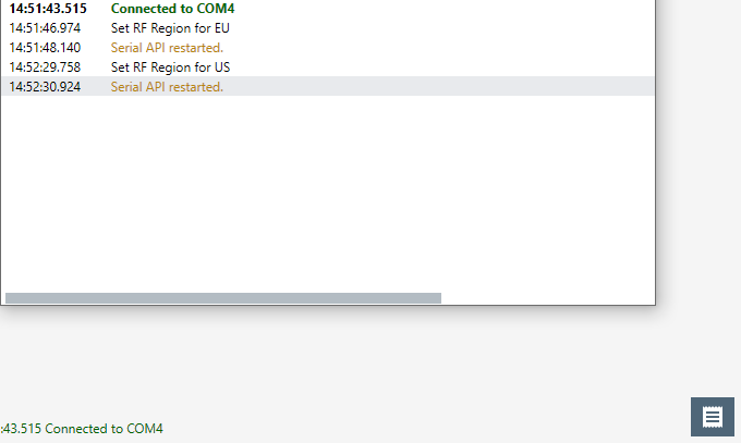

Nice... It was on US ... No next problem... fails to change to EU :joy: :sweat_smile: Will try reboot it
Clicking Set changed it immediately on mine.
You can look at the little paper thing at bottom right to see if it changed it.

Got in now!! THANX!!!!!!!!!!!!!!!!!
Updated w/new info on setting region if outside the US. Thanks to @lewis.heidrick for providing the info/steps!
