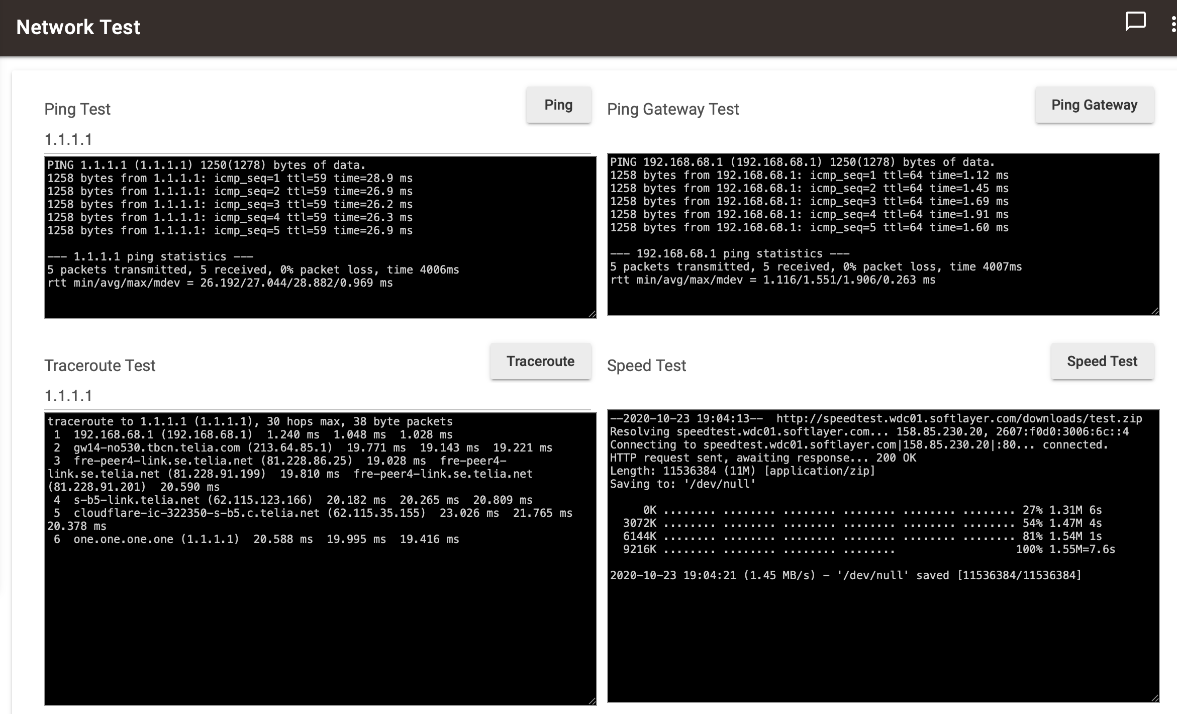

What results do you get when you try the following:

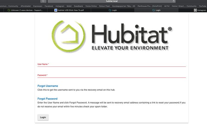

http://hubitat.local/hub/networkTest
I get to login screen
after you login... Also did you configure the subnet mask and gateway for your router on the switch? Did you make sure your switch is in the same subnet as your router's lan side?
Well hub is making it out to the interwebs as seen in your screenshots... Sorry mixing threads...

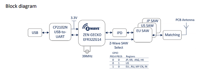

Trying to look up if it supports both frequencies.
Its the last one I got SLUSB001A
Looks like it supports both.
Yes ... hmmm GPIO maybe there are pins to change freq......
