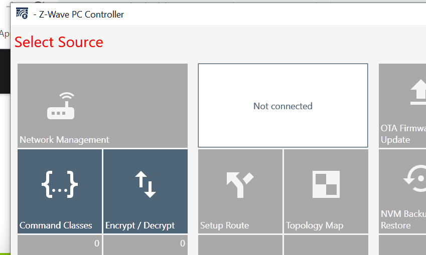

Dammit...I plugged in the UZB stick, I hear happy "usb device connected" chirps from Windows, but no device shows up in Device Manager, and the PC Controller app is not happy:
I have the PC Controller app installed, obviously, I installed (or thought I did) the Zwave SDK yesterday.
How do I get the driver for the UZB stick to see it, and vice-versa?

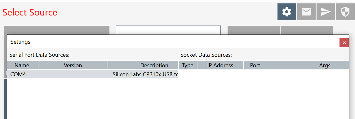

I had to point it to the port in some network screen
it was up in settings
I thought this meant it was already pointed...at com4

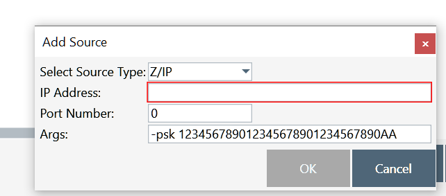

Do I need to complete this? hub IP and a particular port?
From the ADD button
No you don't need anything like that you have what I have

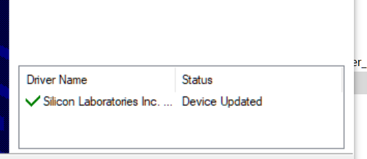

Thanks, ran the install, and got this:
Re-inserting UZB stick and the restarting PC Control.
