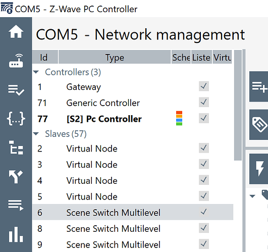

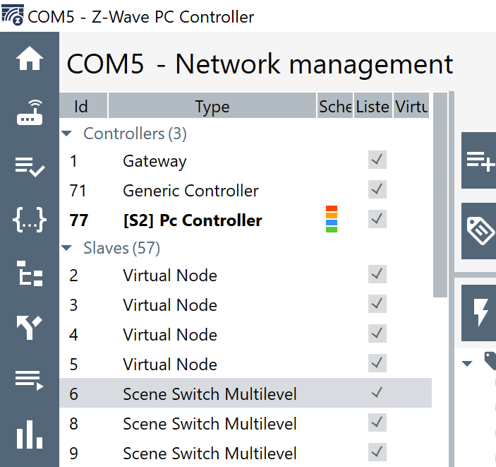

@lewis.heidrick, I am using the Silicon Labs Z-Wave PC Controller with an Aeotec Gen5 USB Z-Wave stick. I can see one of my phantom nodes (node 6), but do not know how to delete it. Any advice on how to delete this would be appreciated.
Node 6 does not show up in my Hubitat "Devices List", but does show up in "Z-wave details".
I do not see 0xa5 in the Silicon Labs software or anywhere in Hubitat, except it is listed as part of a route for node 6.
The Silicon Labs software also shows virtual nodes 2, 3, 4, and 5 that do not seem to appear anywhere in Hubitat - but I have no idea how to remove them either.
That is as expected / designed. Ignore those / don't remove them.
