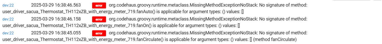

"unknown Mode" in Thermostat template
This driver generate some errors in the log
Did you hit "configure" after changing the driver?
yes multiple times
If you temporarily change the driver to virtual thermostat you should be able to populate the missing attributes to satisfy the dashboard requirement
It does not generate error for me. Just warning.
But the tile display correctly
If you did not use HPM, you probably downloaded the wrong driver.
Look for the driver in the "Merge driver section" in the github repo
I changed for the virtual one to modify the parameter and I put it back with the SinopΓ© driver ... and it works it seems!!!! Thanks!!!!
