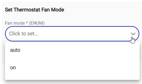

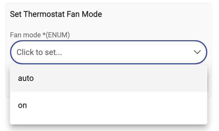

When you click on the pull down that you showed above, does it look something like this?
Yes
Did you click on 'auto'?

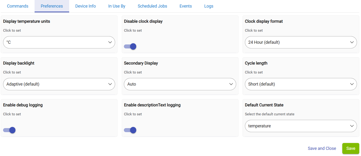

If so, you should make sure that Text Description logging is on, on Preferences tab for the device. Try switching between auto and on using that pull down, and back again, to see if those commands are being logged.

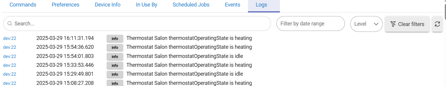

You can filter the Live Logs to just the thermostat device.

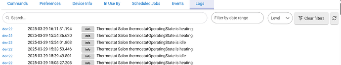

Nothing in the log

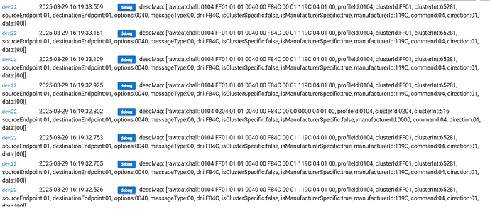

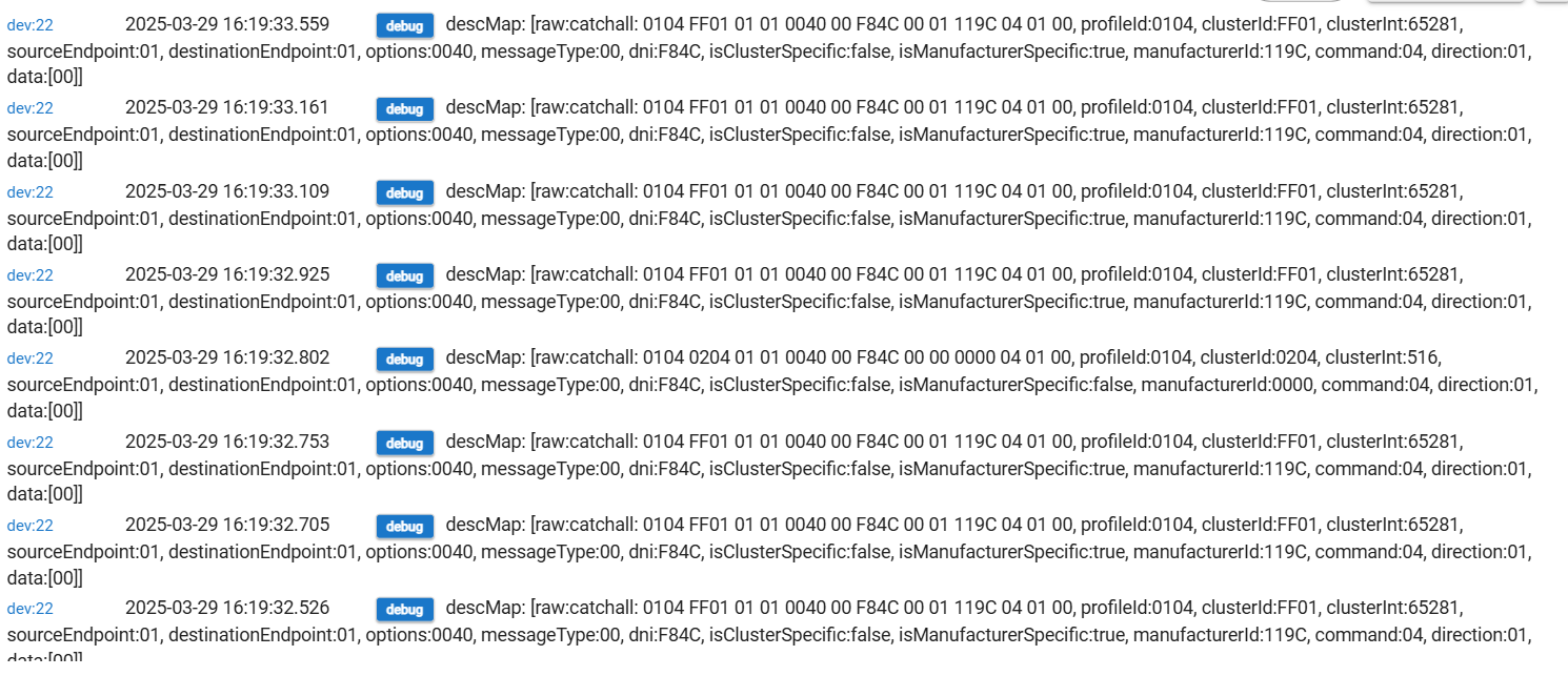

Hit the Configure command. It appears that your thermostat isn't setup properly.
It would be helpful to see the logs from that...
I pushed several times the button ... sorry

Do any of the commands result in log messages?

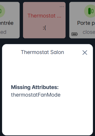

ffs. Then why do you want to monitor Fan Mode on a Dashboard?
I don't wnat, that provide an error on the display
2025-03-29 12_45_46-RdC
2025-03-29 12_45_21-Hubitat Dashboard
EasyDashboard don't work
Sorry, but I can't help you, as I know virtually nothing about Dashboards.
Sorry too, I didn't mean to waste your time...
The EasyDashboard expect to have the fan attribute set even for HVAC system that dont have it. When it came out, some thermostat drivers had to be updated.
