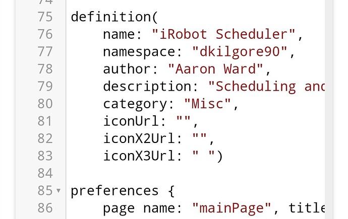

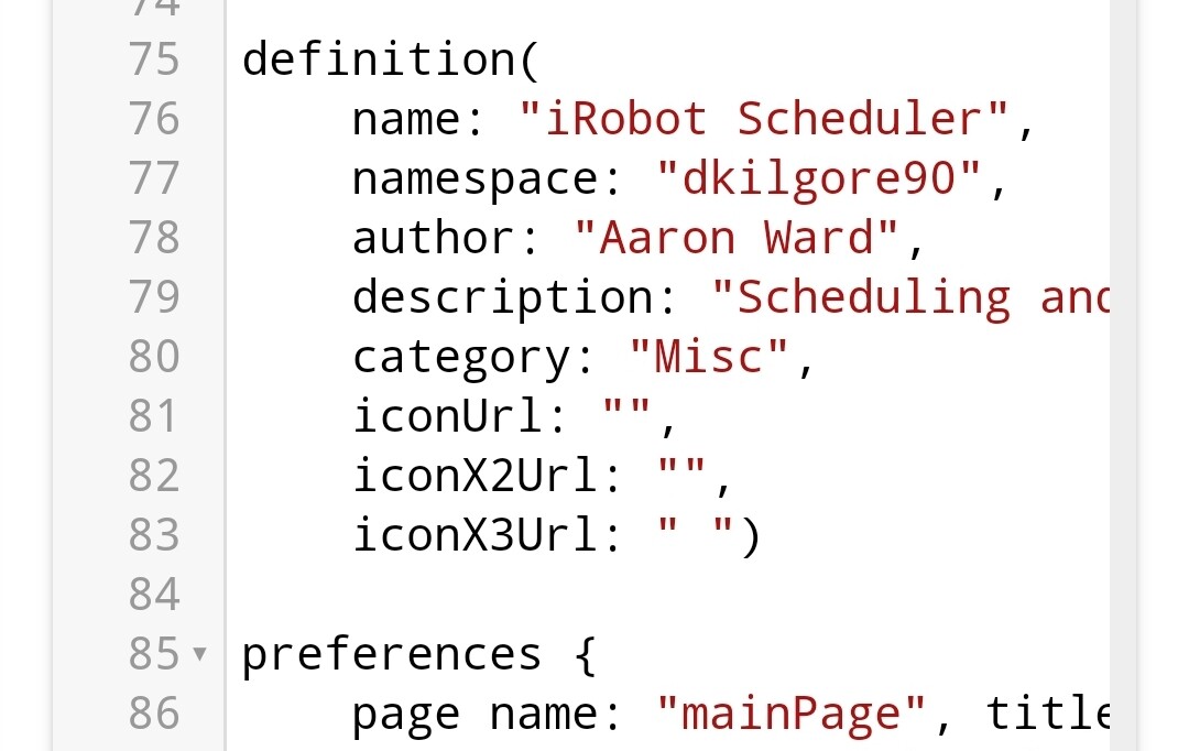

One thing you could try, is to edit the namespace definition in the App and Driver to dkilgore90 -- then run a Match Up in HPM. I'm hoping that this will make HPM change the association to my registry and packageManifest, then it will pull existing and future updates from my repo.
Didn't work.

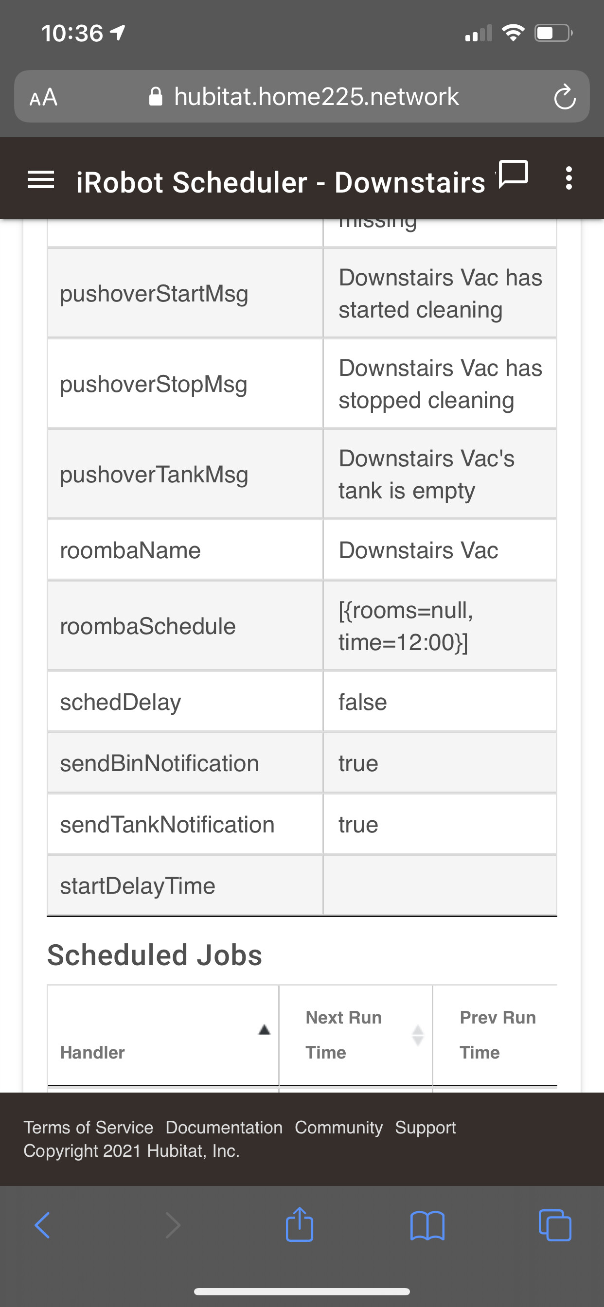

Does anyone have this working when you do NOT specify default rooms? Whenever my scheduled time happens it never runs and it logs an error saying I should use start instead of cleanRooms. From what I can tell it's because the rooms variable is the string value "null" instead of actually being null.
Argh -- I see the problem, the first if in handleDevice, under case "cleanRoom" only checks for default rooms, but not whether the rooms are provided in the call stack -- will push a fix shortly...
Wait a tick... sorry, I think there is an issue there, but might not be your issue.
@dman2306 In your schedule, have you defined any rooms JSON, or is it empty? (Or do you not even have an i7/s9 that is capable of room-based cleaning?)
I do have an i7, and no I did not define any rooms. I just want it to clean everything.
Ok -- can you post (or DM me) the Application State roombaSchedule variable, and the Settings entry roombaOn? Would like to confirm these values to know which code path your schedule should be taking.
And roombaOn is set to start. The problem seems to be rooms is set to the string value null, not actual null
Strange... I agree that it seems that some non-null value is getting passed in, but I'm not sure yet how that might be occurring... with no rooms provided in the schedule on my hub, it properly selects the device.on() instead of cleanRoom. Will keep digging into this, and likely add some additional debug logging to collect data in the next release.
Any luck? I definitely determined that it is getting a string value of "null" I just haven't tracked down where that is happening.
Busy week at my real job :sweat_smile: - but I pushed a quick fix (untested :crossed_fingers:) that should handle the specific case of 'null' as a string. Will try to add some more debug logging when I have more time.
Just an update, it didn’t seem to work for me.
