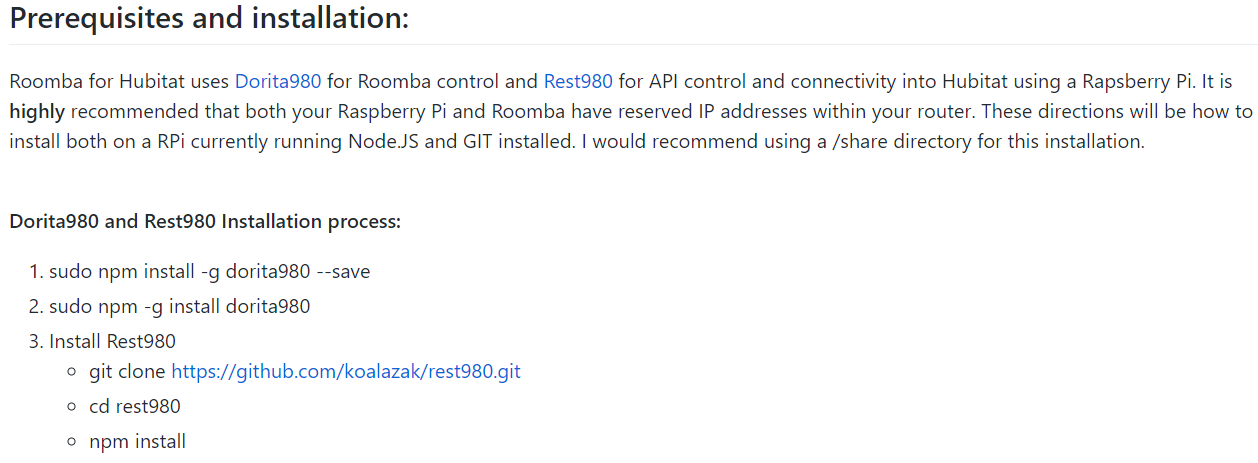

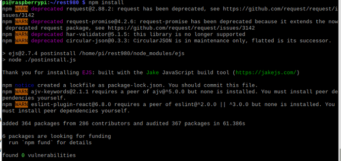

I'm not super versed with rPi, but do have one... I was able to get Node.JS and GIT installed, and then was trying to follow the instructions to get Dorita980 and Rest980 installed:
For Dorita980, it kept giving me this error message:
And for Rest980, this is the error message it's giving me, though maybe Dorita980 needs to be properly installed before Rest980 can be installed...?:
Any help/pointers would be greatly appreciated! Thanks!
