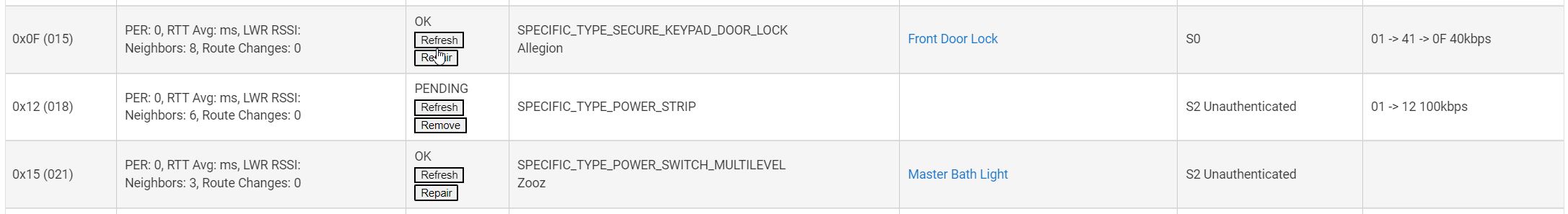

Replaced a ZEN20 power strip. Tried to exclude the old and the device indicated it was removed. The Hubitat had me do a Force. It looked like it finished but the Zwave details still showed it. I did a refresh and then got the REMOVE option. I've clicked on REMOVE numerous times and even reboot the hub but it will not clear. Also the log entry seems like it thinks it's not failed? I've clicked on REFRESH numerous times as well but nothing seems to get it out of there.

@bobbyD just realized I tagged you yesterday on the wrong thread. This is what I have issues with. A ZEN20 that I swapped out for another but when I removed the old and the ZEN20 flashed the LEDs to indicate it had been removed the hub showed it was still there. So I did a force. That finished and the device is gone from the devices page but on the Zwave details page it still exists. I have done REFRESH and REMOVE multiple times and I have rebooted the hub but the device still shows on that page. What can be done to remove it? Thanks and sorry for any confusion yesterday!

Did that. Before I try REMOVE again DISCOVER has reappeared. Would it be worth it to try to put the ZEN20 back in pairing mode and hit DISCOVER and then see if I can remove it assuming it joins? DISCOVER had been there yesterday but finally vanished and would not come back.
