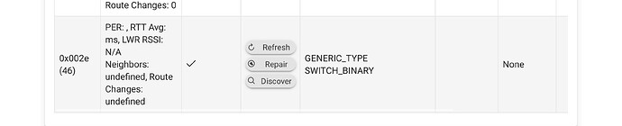

Zwave shows this lonely device:

How about hitting Discover and then Remove, when and if it pops up?

What do you mean Discover then remove? I can get it excluded even after the “failed/partial” re-add
