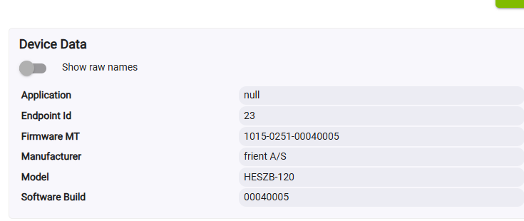

Actually I have some new samples from Frient and am having issues jointing the as well…
I’ll be talking to frient about this as the device isn’t behaving like other frient devices
This is the device that I have (using the 'frient Smoke/Heat Alarm' inbuilt driver) :

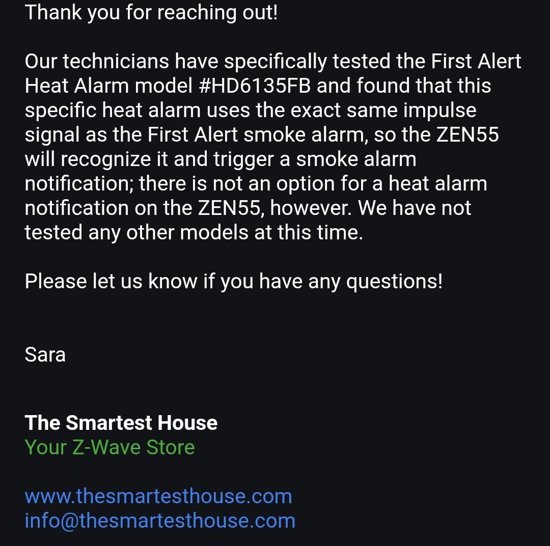

Maybe see if wired heat detectors like a first alert will work with a zen55.
Interesting, I'll definitely look into that. Hardwired would be way better for my scenario, as we have pretty brutal winters, and a battery blpowered device would drain batteries extremely quick.
Unfortunately it looks like the Zooz won't work. It doesn't send out a specific signal for a heat alarm event. This was the response I got back from TheSmartestHouse.

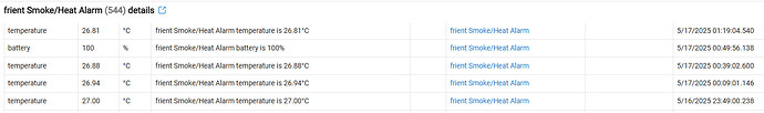

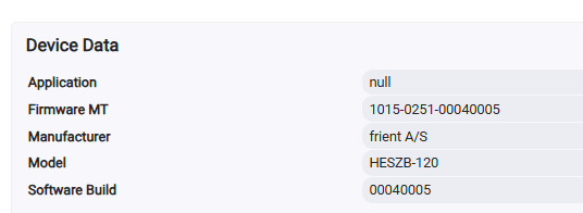

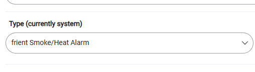

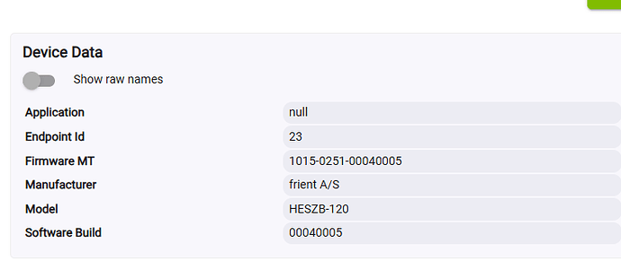

My Frient Heat Alarm is working very stable paired to a C-8 (non-Pro) hub. Never disconnected, but pairing was difficult...`
Using the inbuilt driver, it reports regularly the temperature and the battery level
If your hub is the old C-7 model, try pairing the Frient device immediately after rebooting the hub. Pair as soon as the C-7 web UI becomes responsive after the reboot.
