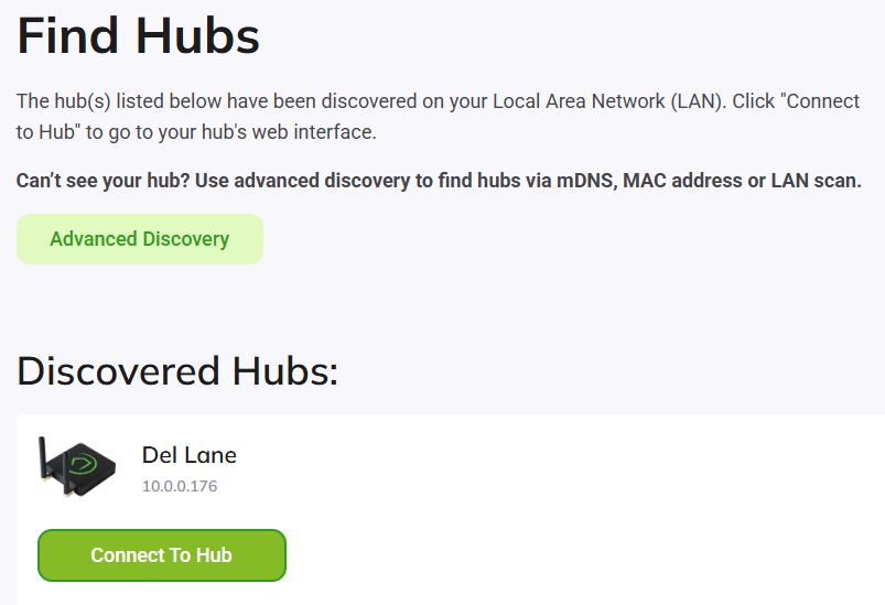

When I click on Connect to Hub, what I get is " we could not verify the certificate: reason = untrusted"

I have tried on both smartphone and PC. When I click on "Connect to Hub" on PC, I get the message [quote="paradisehanggliding, post:1, topic:153419"]
[/quote]
On the Smartphone, it takes me to the "Add Devices" page no problem, it's just that nothing I do with any of the devices will allow them to be discovered or included. I've tried every which way such as selecting from a list, by manufacturer, and manual inclusion. The only device (out of several I have tried repeatedly) the hub has seen after hours of trying is the smartphone itself. I have followed all the procedures to the letter multiple times with multiple devices, you would think I would get lucky and get at least one of them to be discovered. Is there a way to troubleshoot or just completely reset?

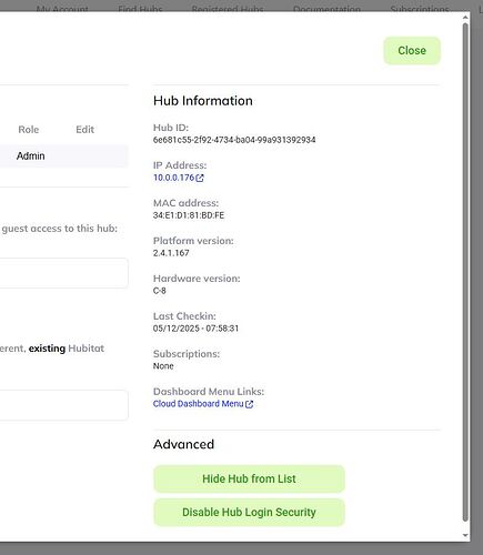

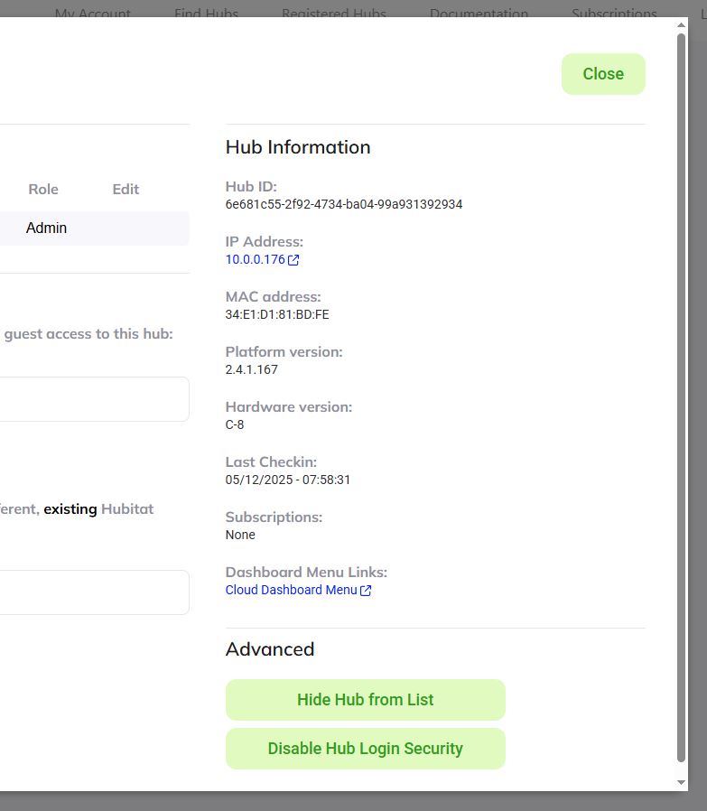

Were you ever able to Register the Hubitat Hub with Hubitat's cloud server? This is found at https://my.hubitat.com

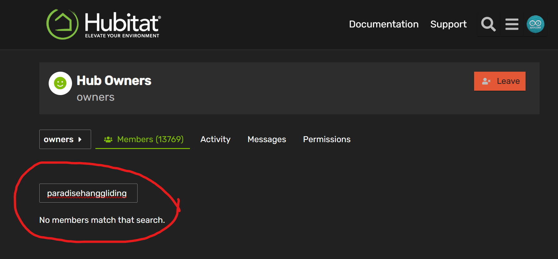

Join the Owner's Group and you'll be able to post images, etc.
Yes I still get the "untrusted" message. Using Chrome, I did not change any of the hub settings, everything is on the same network, the hub is registered and shows up on the PC with all details. Everything is close to the router with a strong signal.
I am replying through the owners group and it still does not allow me to upload images. It does not allow me to quote, even though both of these functions are included in the interface.

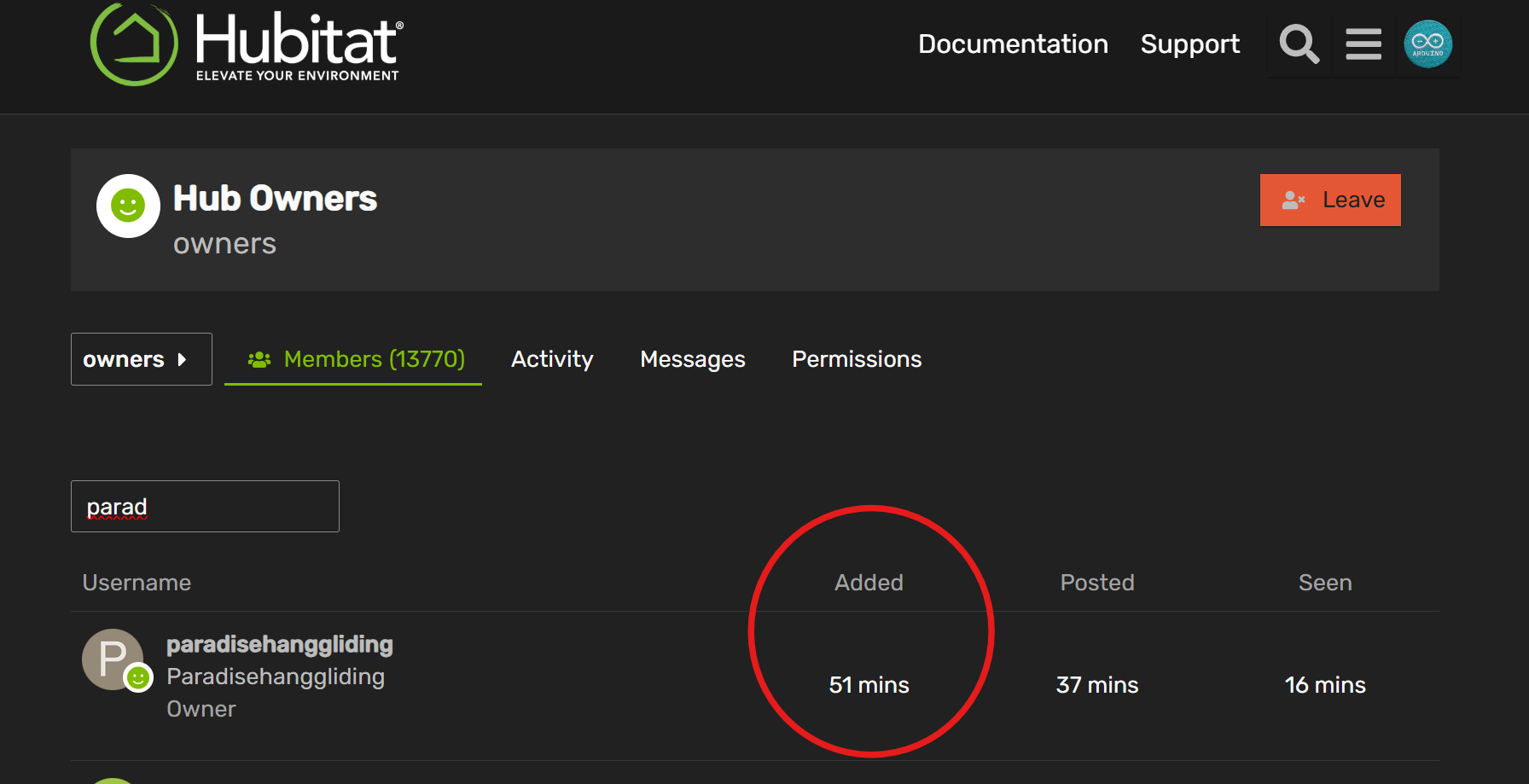

You need to add yourself to the "Hubitat Owners" group in order to post images.
Looks like you are still not a member.
Please JOIN this group - Groups - Hubitat
Afterwards, please post an image of what you're seeing. As it is difficult to understand exactly what it going on.
I am a member, I joined yesterday, everything I see at my end shows I am a member including when I performed a self-search. I even see the red box that says LEAVE like in your screenshot. Every reply I am making is through the owner's group while logged in. I have multiple screenshots I have been trying to post, but when I upload them, it just shows code for a link (although it is not actually a link) and the forum tells me I cannot post links.

It now shows you as a member of the Owners group.
Hopefully, refreshing your browser will allow you to post images. To post an image from a PC, I simply COPY the image (like from the Windows Snipping Tool) and the PASTE it into this edit window. On the right hand side of my screen, is the preview window which should show your actual image, once it finishes uploading. On the Edit side (left side) all you will see is a funky link that looks like

When I click on "connect to Hub" on PC, I get the "not trusted" message.

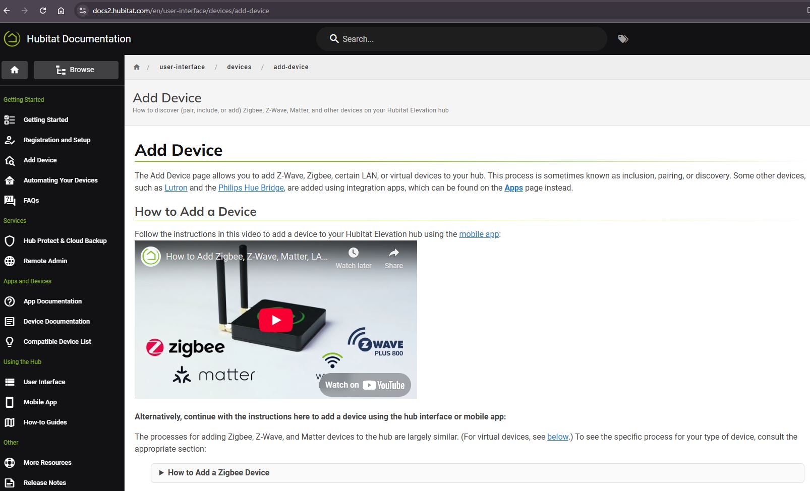

OK just to prove how stupid I am, how do I find the actual desktop app? The closest thing I can find to something that actually does anything on my PC is this, but when I click on ADD DEVICE it only gives instructions on how to add a device, but no way to actually add a device. Is there a download for a desktop app that does anything functional?
I see in the tutorials people using a cool-looking app with all kinds of functions. There must be a download somewhere.
There's not a desktop app -- you simply access the hub directly on your local network.
