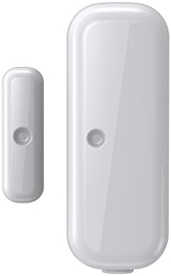

I’m looking for a zwave or zigbee low cost contact sensor (or similar) battery operated device that I could wire a pressure mat up to. Lots of US Zwave contact sensors with dry inputs but can find anything for purchase in the UK.

I've just bought a batch of 20 Iris window/door sensors from US off Ebay
Worked out to be under £4 each after postage and import taxes, already used a few for doors but the aim for the others is to create room presence sensors with pressure mats.
At £4 each it's a no brainer, even if I knacker a few adding them to pressure mats it's still cheaper than buying local
Interesting. How do you plan to convert them?
I watched a video on YouTube where they soldered the wires from a pressure mat go the circuit board in a sensor then added a cut out to sensor case for the wire, thought I'd give it a try.

Would a leak sensor do the trick?
Found these on Amazon https://www.amazon.co.uk/gp/product/B014JS581E/ref=ox_sc_saved_title_2?smid=A1GEQ9JX5SYFB1&psc=1
I have one here which works very well, but could be used for your project?
I have found that leak sensors are not designed to run on "contact closed" state for a long period of time. I think that they pass quite a high current to be able to close the contact using water and consequently run their battery flat very quicky when faced with a wired contact shorting out the leak detection.
Modifying door open / closed contacts is a better way of doing it.

You have a point for a pressure mat as you shouldn't be standing on it for very long. I used a modified water sensor on the relay controlling the "low temperature" lamp on my freezer and it only lasted 2 days before the battery ran flat. I found that using a modified door sensor was more reliable. for the pressure mat you could also use a modified push-button as this is effectively what the mat is, a very large push button.

My use case is to stick our wheelie bin on top of it and for it to notify us if the wheelie bin was still there on bin day that we hadn’t put it out for collection... not something I want to spend a huge sum on obviously :slight_smile: However, it was my girlfriends suggestion and she’s not in to HA in any sort of way so could be the start of a positive sign :slight_smile:

It works !
