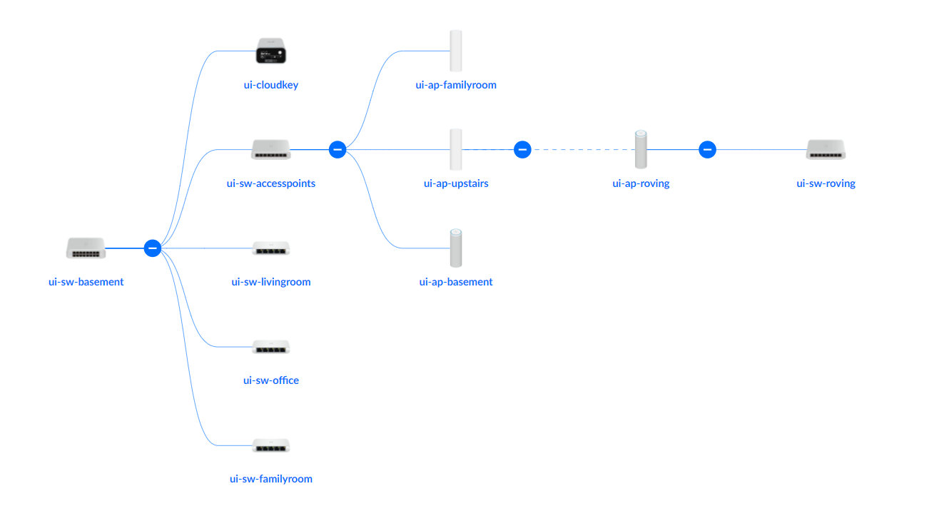

I am doing this with my "roving" switch I put in the back yard when we have parties. I roll out the party equipment which uses the older HD Flex HD AP to a 8 port POE switch which connect the Wifi 6 mesh AP. With this config the guests get Wifi Access and my hard wired devices like music and video plug into the switch. When it's outside a device on 2.4 GHz literally stays connected as you walk around the block. The Flex HD's and Wifi 6 Mesh devices are great.
Here is my topology:
That is a great idea for connecting it up. Thanks for sharing!
So I have a Flex HD in my garage in a more permanent type installation and for security reasons would prefer it NOT to work like this. I wonder if there is a way to disable? :thinking:
note: I have a simple POE injector with 2 ports. Have not tested "wired" access yet but assume it works the way you have it set up..
Security works normally. SSID's and passwords for wireless for my private networks and guest network is on it's own VLAN, each wired port is MAC assigned so while the cart is out only authorized devices have access. This is a rollout and then put away solution.
Yep figured - want to extend my home WiFi had the Flex lying around so went for it. Works but probably not the most secure thing - although I do have cameras etc all around.
