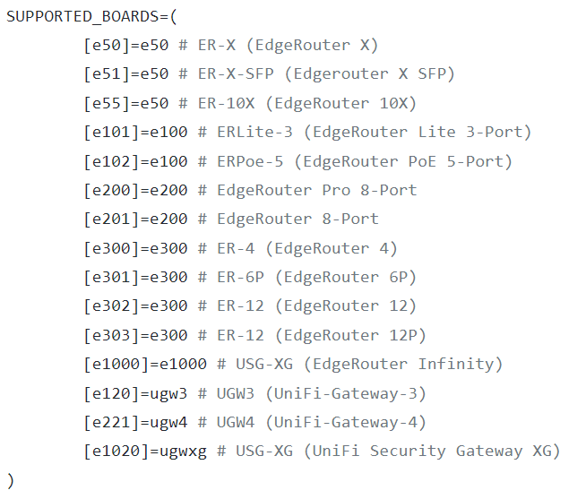

WireGuard is still the best, IMHO. Also supported on several U devices:
  • WireGuard for EdgeRouter, Unifi Gateway and Unifi Dream Machine:
And a Unifi community developed Ubiquiti install script here:
U devices the install script supports:

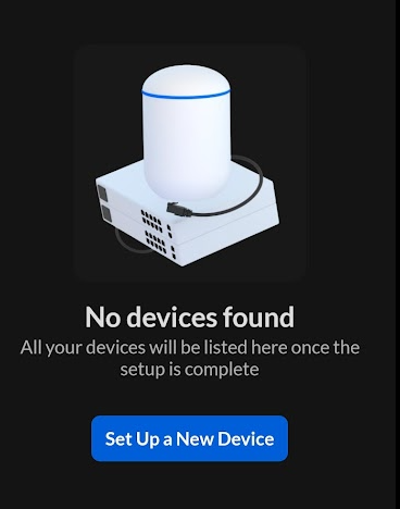

General question...I haven't used Unifi mobile apps at all for some reason, just access my controller on my Pi from my laptop.
I did download the Unifi Network app the other day, and found you can't use it if you have your AP on a controller (I have my controller running on a Pi), as far as I can tell. Am I missing something? The controller web page UI on a mobile phone is terrible, not designed to be responsive for mobile devices at all.

Can you confirm your settings in the app?
When I start the app it says it's looking for devices and then finds none and prompts me to add a device.

I just deleted the app on my old iPhone to walk through this again.
  • Click setup new device
  • It searches for consoles and fails
  • At bottom option Other Setup Options
  • Set up a connection by IP address
  • Give it a name, enter IP address of your Pi, and change port if you aren't using default
That’s all I had to do and hopefully same on your end.
Perfect...thanks, I never clicked on that since my APs had already been set up. DOH - forgot my most basic rule, try clicking everything at least once before giving up. (Which, incidentally, is why you really don't want me defusing bombs.) :wink:
Appreciate it - so nice to see things in a proper mobile-sized/designed UI!
