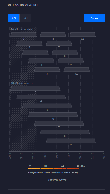

I've been lazy power wise, auto has seemed fine. If you had multiple APs and wanted clients to roam between APs, a lower transmit power is generally recommended. I would recommend increasing your 5Ghz width to 80, you're not going to get full speeds out of the AP set to 40 (and is generally the recommendation I've seen). Unless you are living in a rural area with no interference, I'd also recommend doing an RF scan from the AP and explicitly pick channels with the least interference vs leaving it on auto.

Not rural, no goats or pigs. :wink: Next door neighbors house on one side is about 40' away, on other side they are up a 30' hill from us and set back, so pretty far away. I do see neighboring Wi-Fi networks when I do a scan but they are very weak by the time they get to me. I'm going to do a scan and se what it reveals. Haven't done that in a while.

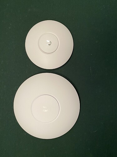

I just got mine too and yes much bigger. Smaller is a UAP-AC-Lite

Yes! Even though I thought I was prepared for it from seeing it in the video, when it arrived the box was so heavy and the AP felt like a monster frisbee in hand. The frisbee that ate NY City. :slight_smile:
Luckily it does not look crazy big at all once installed on the ceiling. I've already forgotten about it and don't notice it at all, and I don't think my wife will ever notice or care. Nice!
