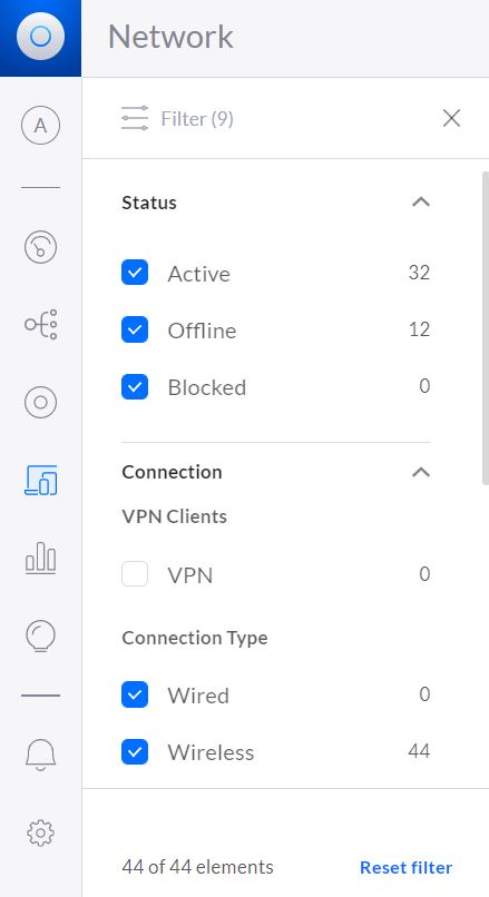

I just looked at my client list and noticed that many clients were not showing up.
I fiddled around in the "Filters" section:
2021-09-24 11_37_06-UniFi Network
And what worked for me was changing from "All devices" to just the U6-LR, and then back to "All Devices."
I found if I just select offline devices it works, but the devices are clearly not offline... very weird.
I opened a support ticket.
I had this happen to me last night after setting up my LRs. I restarted the APs and the controller and they came back. Been fine ever since. Please keep us posted on the support ticket.
