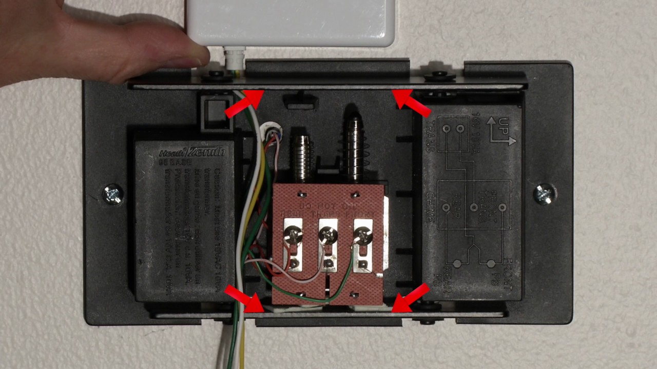

I'm trying to do the same thing with my hubitat. I have the Unifi G4 Doorbell. Working fine no issues. Then today I got the Sage DoorBell Sensor I can't get the RM to work to send a message to my phone.
I just checked my transformer. It's 16V 10A. Should I buy a bigger transformer that has more amps? Possible not enough amperage?

Mine is pretty much the same. I had Front Trans and Rear labelled on mine.

The Doorbell rings when I press the button. No issue there.
That looks correct. Does the the sensor register any events on the device page? and does you top section look like this?

The only thing I can think if is the amperage. 10amps is that enough for the G4 and the sage? Also it's 16v. Would 24v be better? I can change the chime box if needed.
