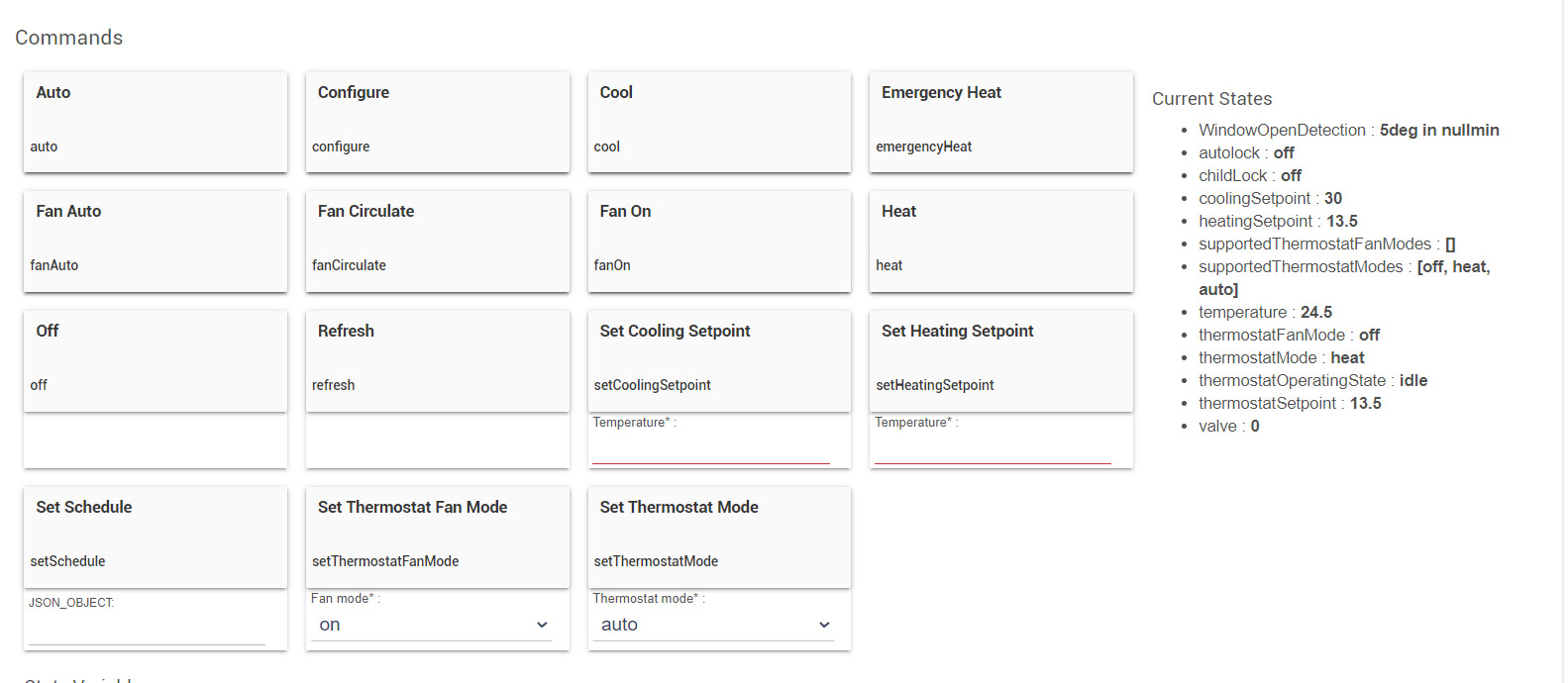

I got this on the device info page.
But i can't set the heating setpoint. It doesn't matter what i write in the field it's not changing.
Can i just turn off /on the valve?
Ohh.. got it.
It seems the maximum degree is 25 what i can set.
I always tried 28 to write in, but nothing happened.
So 25 is the max
You can change the max and min on the device as well
I changed it there, but that's not infect the limits in the app...
Is it changeable in the app somehow?
I can't see anything in the code which would stop it
Its a guess but if you look in the code for coolingSetpoint and change that to 35 then try 29 on the heating??
