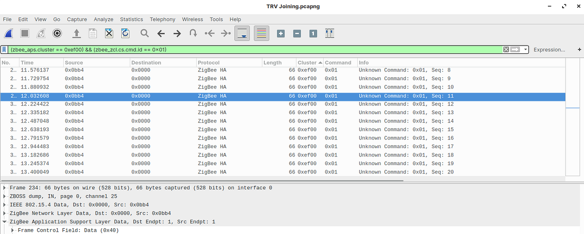

Hi Guys. Thanks for the hard work you're putting in here. Don't know if you've seen this article - has a list of commands that were packet sniffed
