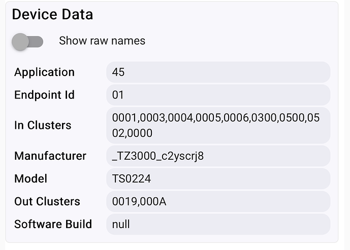

Also, please post an image of your "Device Data" from the "Device Info" tab for this product.
I attached an image of the device data. I tried a Tuya Zigbee Siren driver I found a few years back that works with another siren I have. I don't know where I grabbed it, but the first few lines of code are:

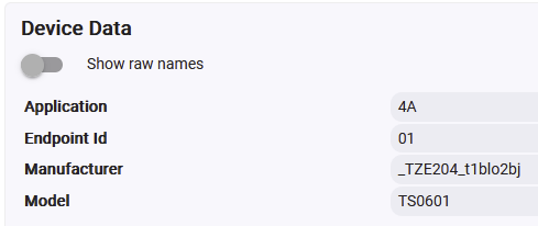

The "Tuya Smart Siren Zigbee" driver worked for me, but my similar looking sirens are based on a different Tuya chip set in a product from a different manufacturer:
And, I just reached the limit of my knowledge in this area, sorry!
Tuya TS0601 devices are controlled differently from TS0224 devices, so the existing Tuya Smart Siren Zigbee driver will not work for your device.
TS0224 _TZ3000_c2yscrj8 uses the standard Zigbee IAS Warning Device (IAS WD) cluster (cluster 0x0502) to start the siren. There were some posts about a similar device here, but the development of a driver went nowhere at that time.

Thank you for the logs, @sethbartal !
I see two problems :
The first is that your device model:"TS0224", manufacturer:"_TZ3000_c2yscrj8" is not supported in this driver, but it could be added in the future, or maybe we can find another driver that already supports the IAS WD (0x0502) cluster to control the siren.
The second problem is more critical - the device does not stay connected to the HE hub Zigbee network. It keeps changing the short addresses (dni:2653, 6F23, then CA3C), which means the device is dropping and re-joining repeatedly. That matches the 'rapid red flashing' that you observe.
The most likely reason for the rejoining loop is that the device expects an answer or an initialization command from the hub that is missing.

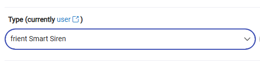

  2. Manually change the driver to the HE inbuilt 'frient Smart Siren' and try pairing again
Try also this driver :
First manually install the driver code, then assign it to your device and obligatory pair the siren again.
