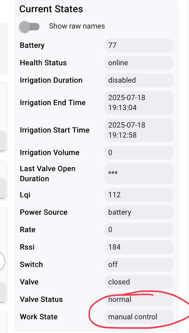

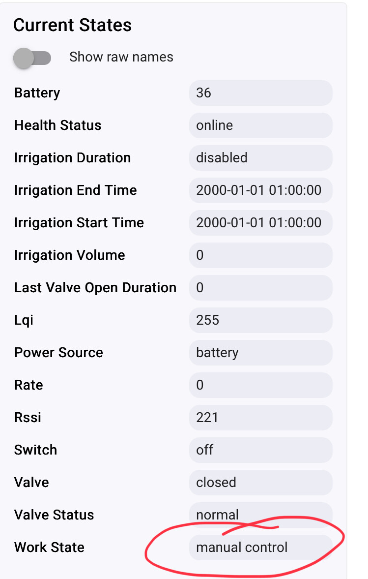

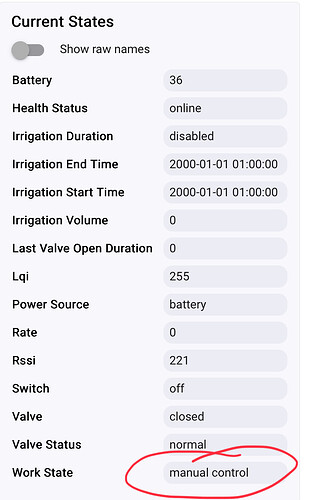

anyone knows what this 2x quick flashing means? Troublesooting manual was not attached. And what does it mean: manual control?
Covered in post #4 above, but here's a screenshot.

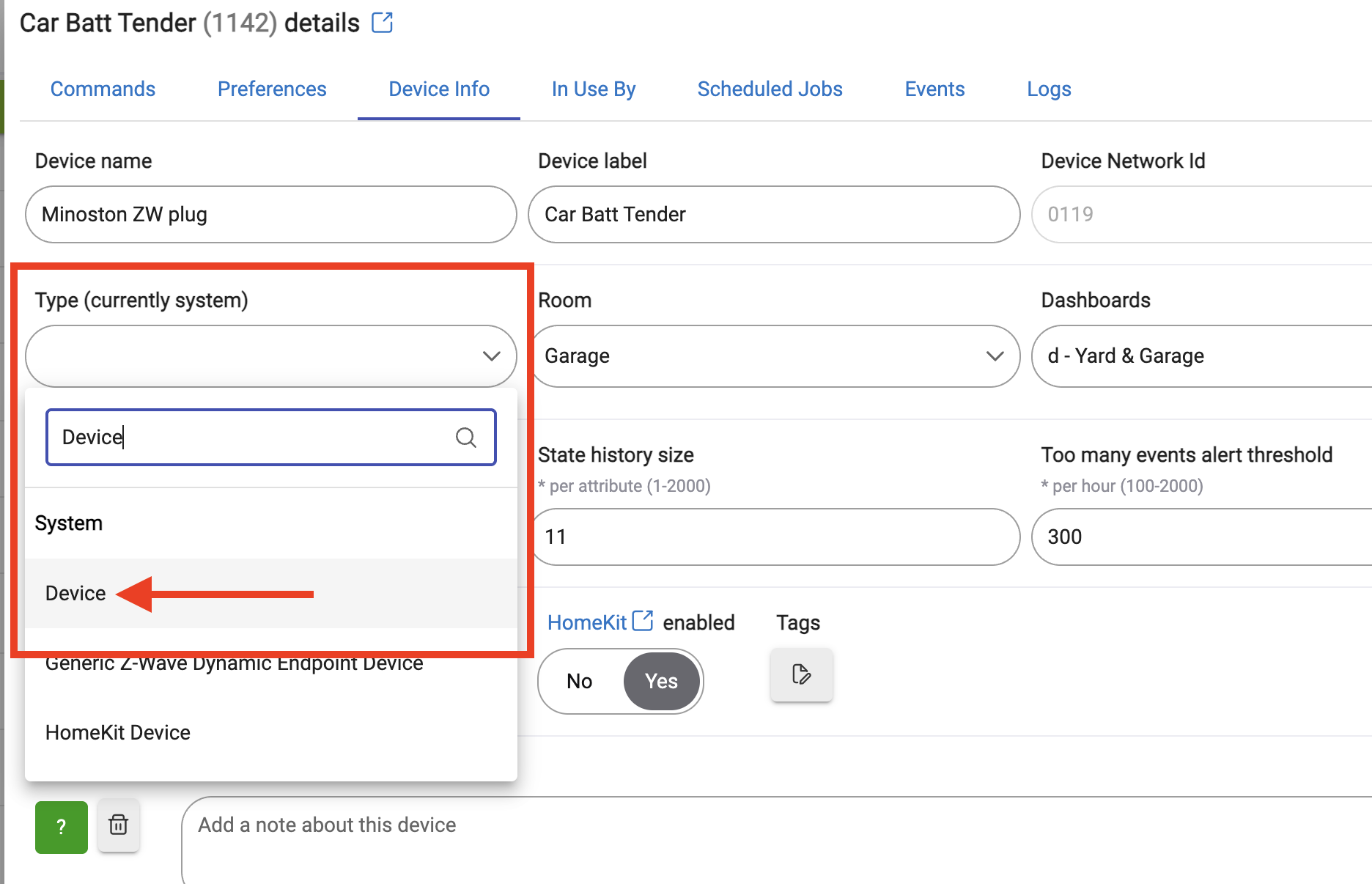

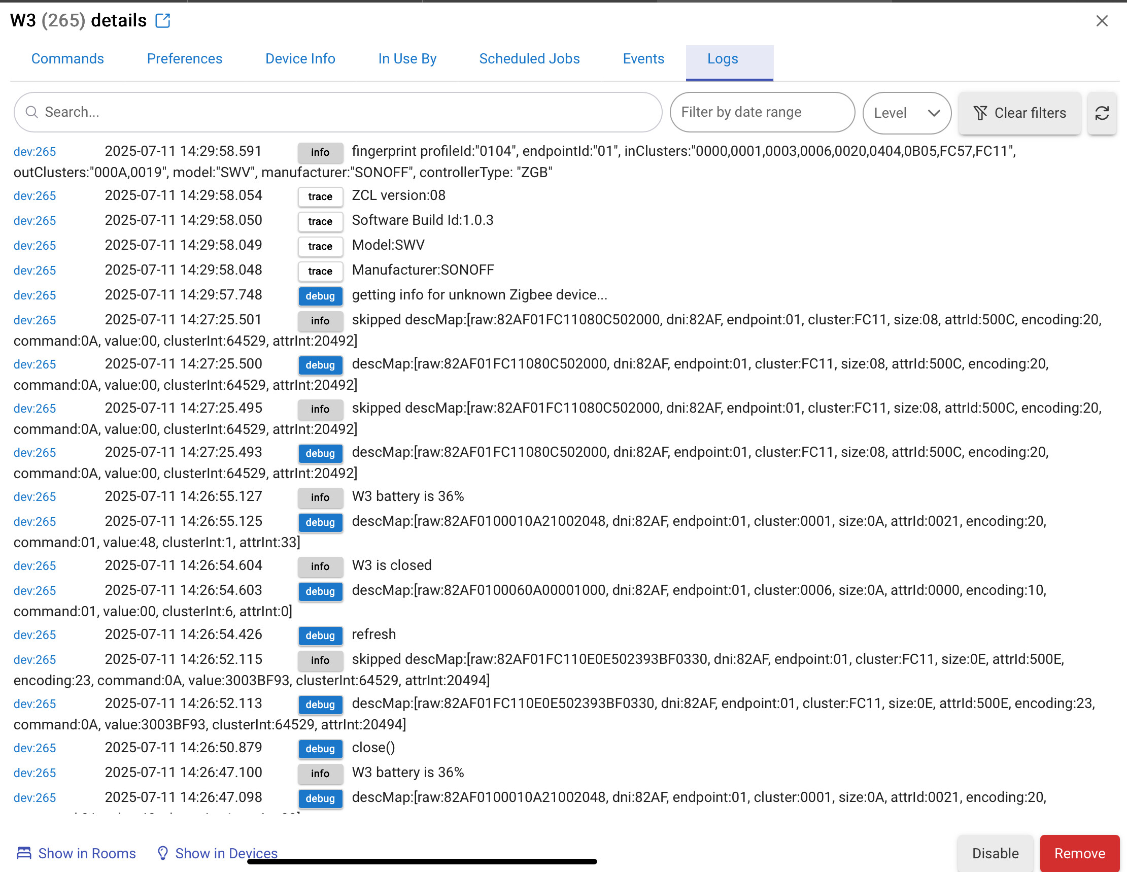

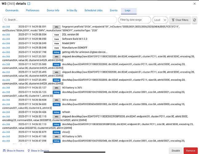

My log before and after changing to Device and ā€žGet infoā€:
All seems OK here, the device stays connected.
Can you try new batteries ?
The Battery level decoded is only 36%, maybe there is not enough energy left to actuate the valve? :thinking:

It Works in manual controlling?.. WhatsApp does it mean?
ā€œmanual controlā€ is reported back from the Sonoff valve and means that the valve is manually controlled - either from the physical button or from the Zigbee interface open/close commands. This is opposite to the automatic closure mode when the valve will close after reaching a preset water volume or after a preset timeout.

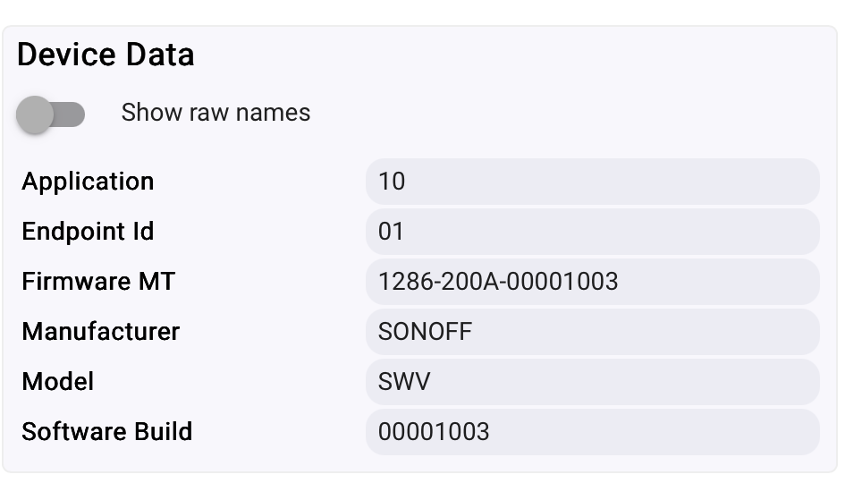

Can you post a screenshot of the valve firmware version - it can be found at the bottom of the Device Info tab, above the Zigbee model and Manufacturer data.
The SWV firmware is the same version as mine…
