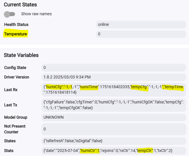

Strange is that after exchange of drivers I see variables like for temp/hum sensor:
My device parameters:
and some data from the log:

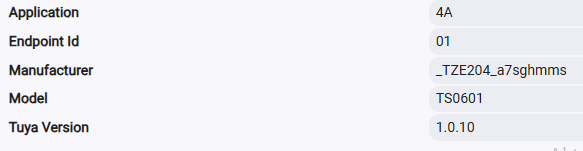

HI @PM_Disaster,
TS0601 _TZE204_a7sghmms

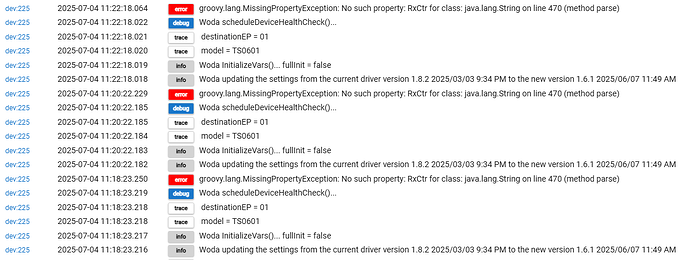

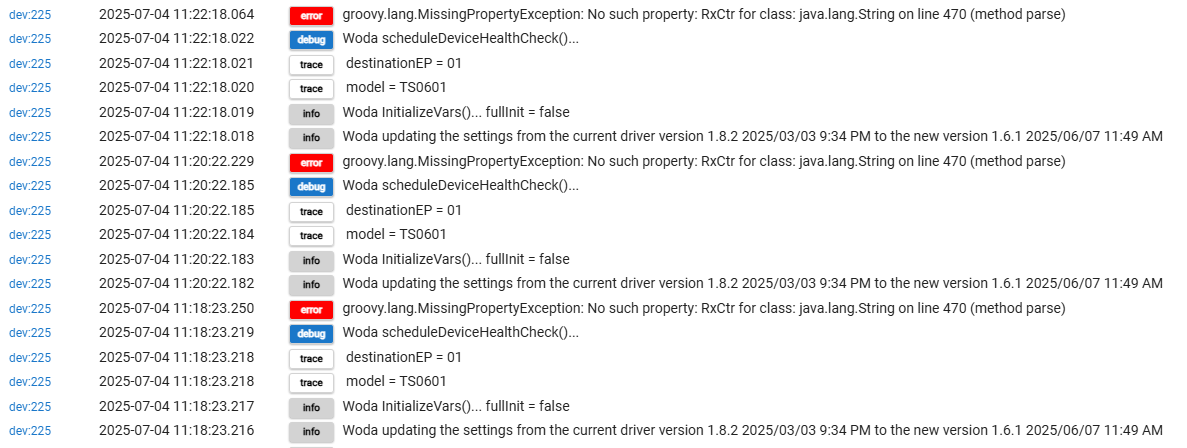

Enabled the Debug logging again. Do you still see the ERROR exception in the logs?

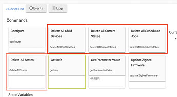

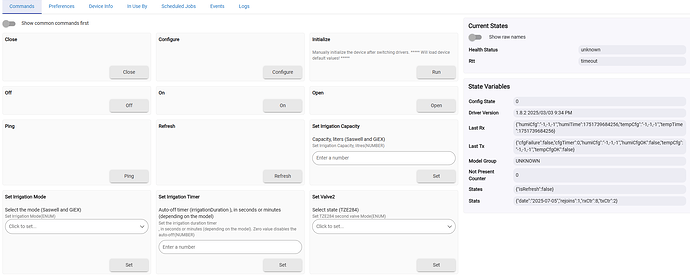

You need to change the device's driver ("Type") selection to the option that's literally named just plain "Device" -- it'll be in the "Type" selection menu. This "Device" selection is a useful maintenance tool.
Once you change to the Device driver, refresh that device page and go to its "Commands" tab page. As shown below, that's where you have the "Get Info" button and all the various "Delete" buttons Krassimir mentioned.
When you switch back to the "Tuya Zigbee Valve" driver, refresh that device page again, and then the "Initialize" button will be on its "Commands" tab page.

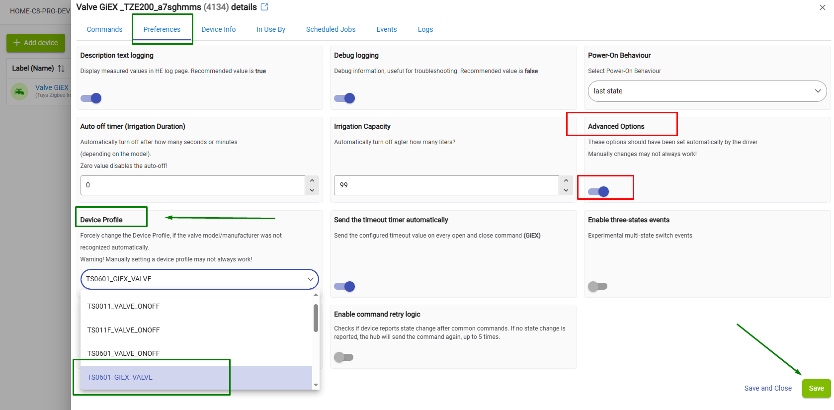

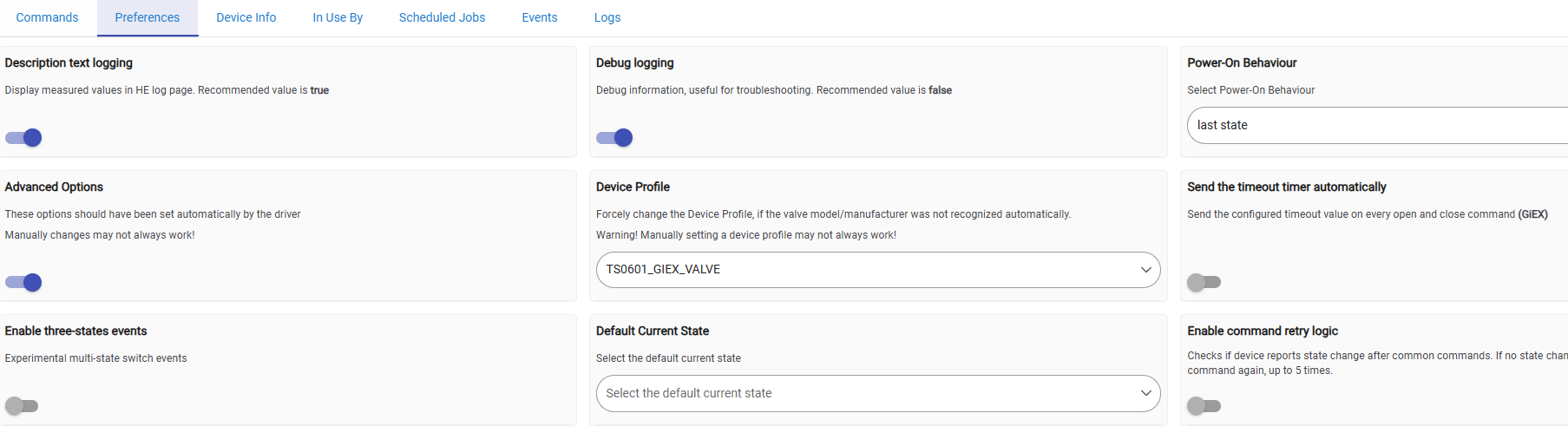

In adition to what Chris already detailed (thanks!), here is a screenshot of how to change the 'device profile' type manually :
You need to enable the 'Advanced options' first, then save the settings and refresh. Now the list of the different valves will be visible - select the 'TS0601_GIEX_VALVE' and then click on the preferences tab Save button again.

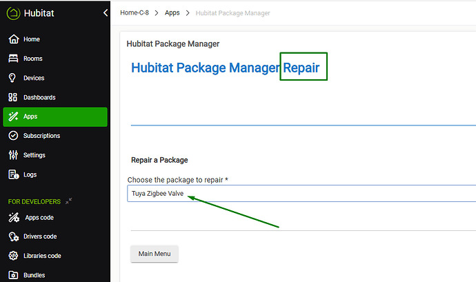

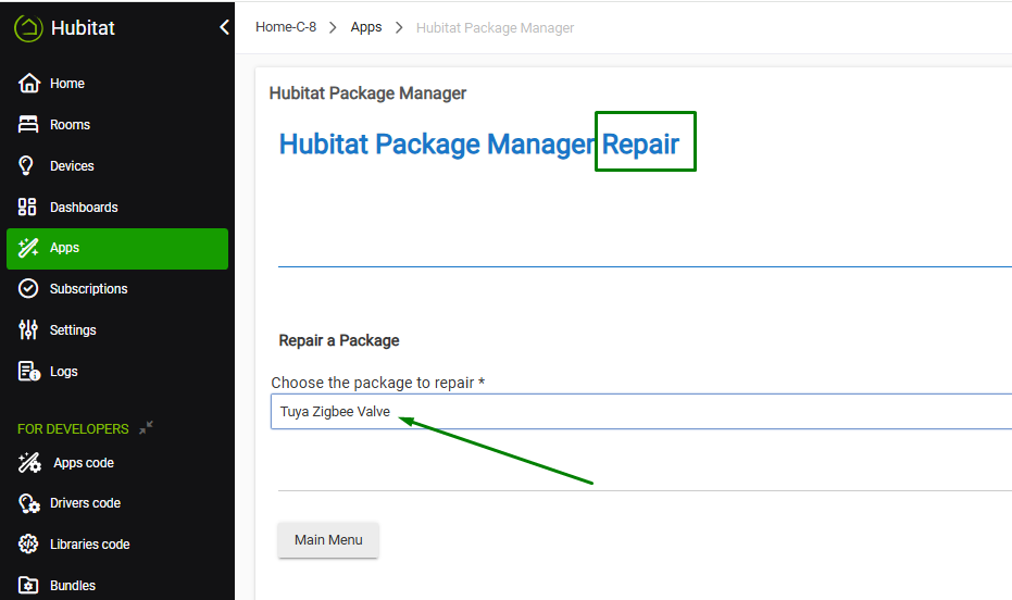

If you installed the driver from HPM, you can also use the 'Repair' function :

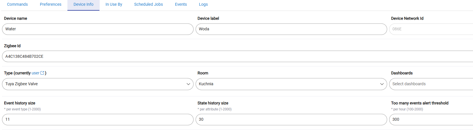

Package repaired. Advanced options selected.

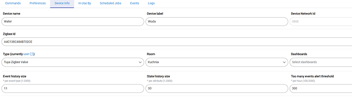

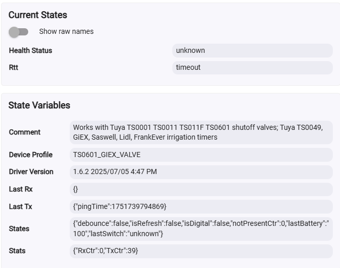

Device info:
Pref:

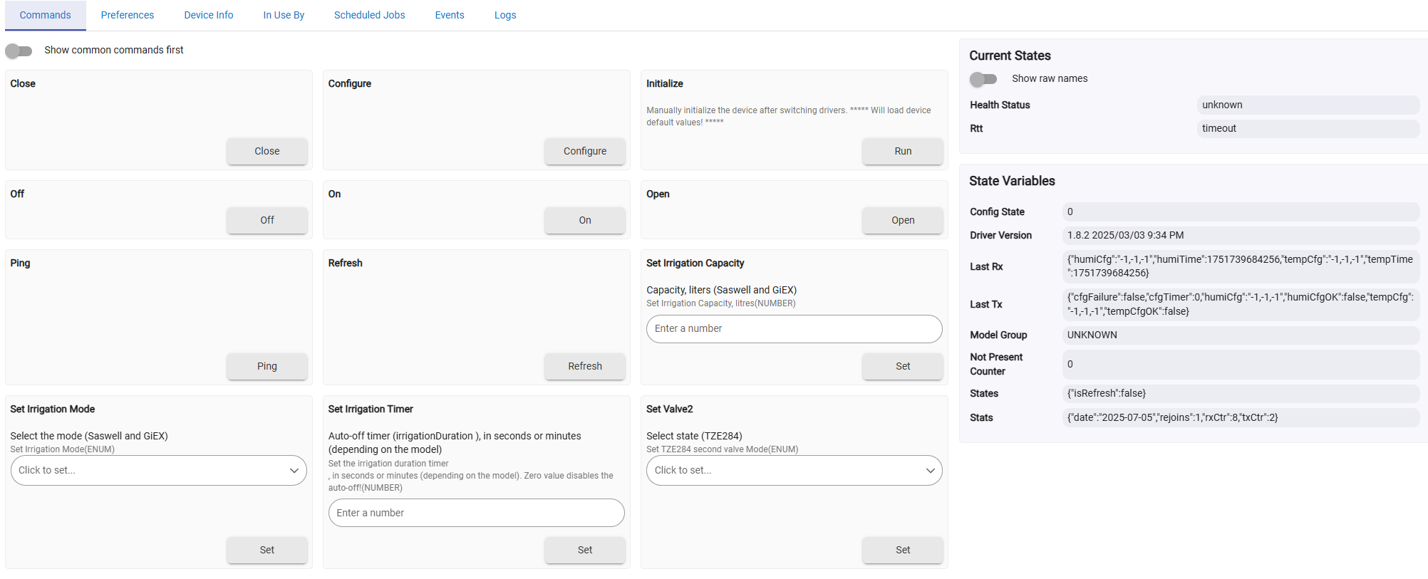

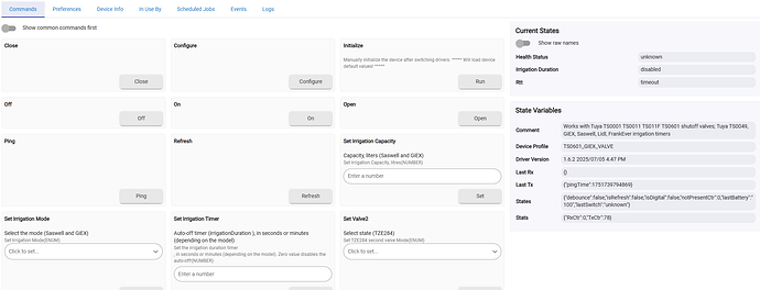

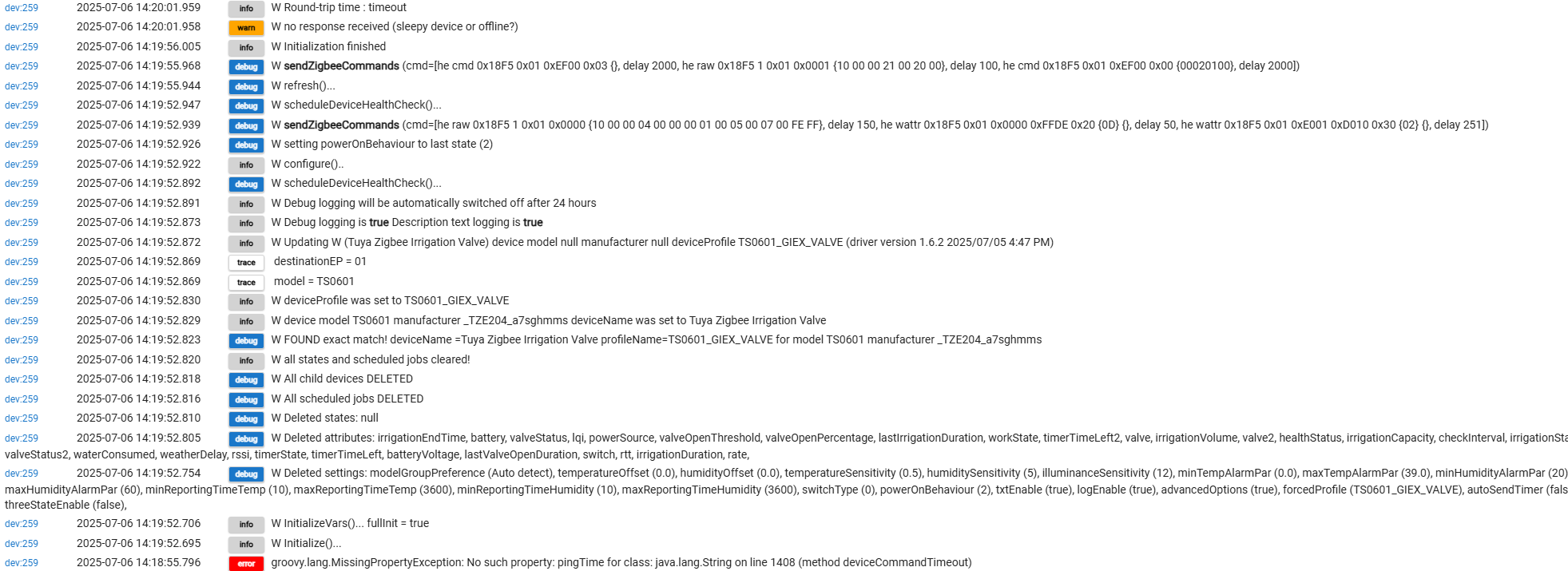

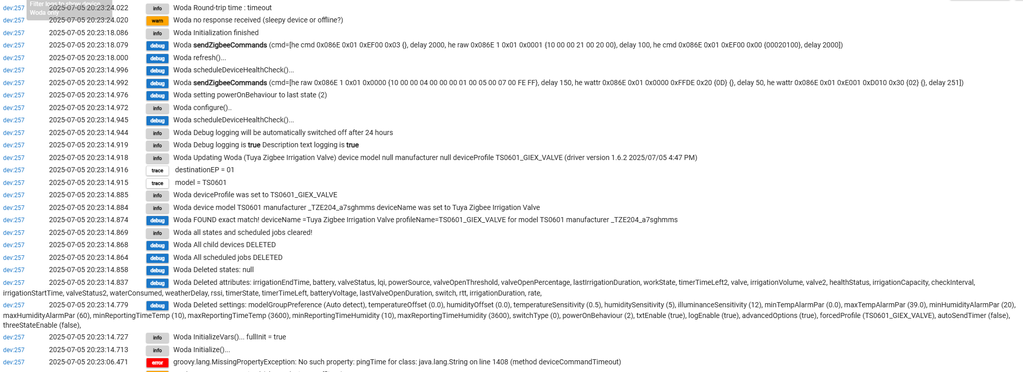

Still no change in command section:

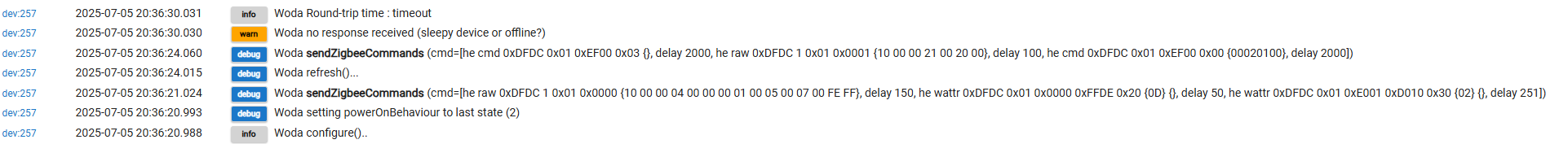

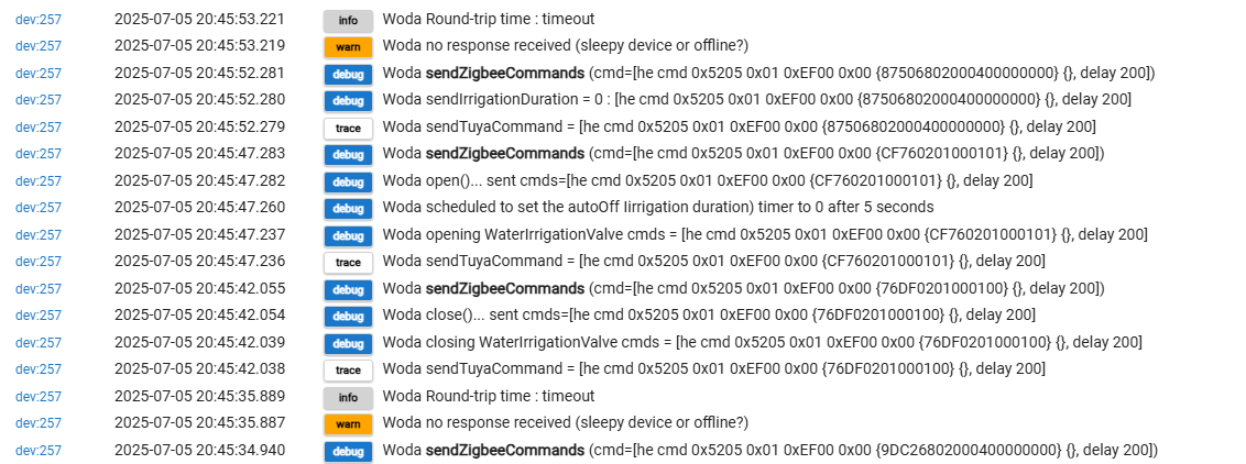

But no error in Log:
Did something wrong?
Device after pressing the button OPEN started to flash several times and the screen changed after refresh:
but now not responding any button:

Command screen - no changes with the buttons.

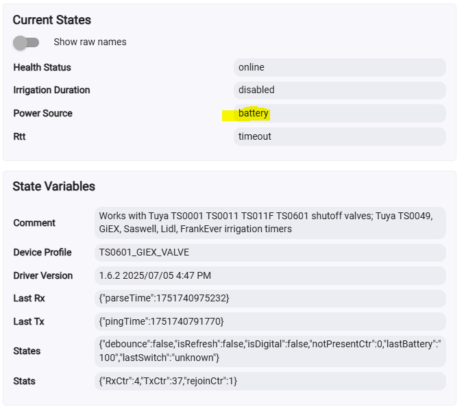

Only change is additional line in Currend States - power source line

Did you follow the instructions precisely? What distance from the hub are you pairing the valve? Note that the key point of the voodoo is to rebuild the Zigbee network twice.
The screenshot shows that the device has sent 4 Zigbee messages successfully, but has dropped off the network after that. This happens typically when it is paired not directly to the C-8 hub, but via a nearby mains-powered device (Zigbee repeater).

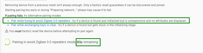

Try to pair again as a new device, using the Double Luck voodoo. Make it close to the hub (one meter distance is OK). Start the pairing process after rebuilding the network twice in 'Pair while trying to avoid Zigbee 3.0 repeaters' mode only after the count-down timer has started :
If the device remains connected, you will see the valve's open/close state change on the device web page when you manually turn it on and off using the device button. There is no need to click on any Command buttons at this stage; use the physical valve button only and observe the debug logs. Every press of the valve on/off physical button should generate new messages in the device live logs. If no new messages, the pairing didn't work... :frowning:

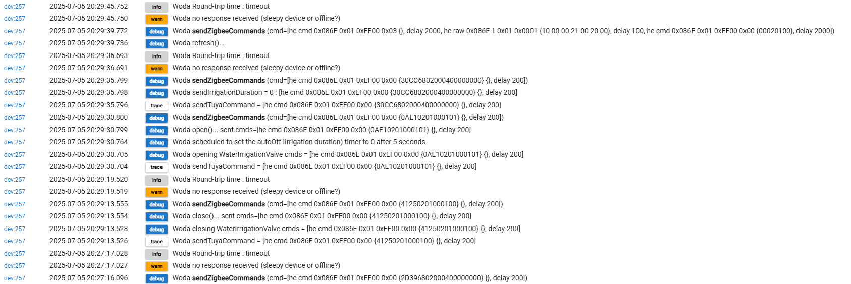

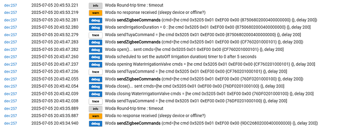

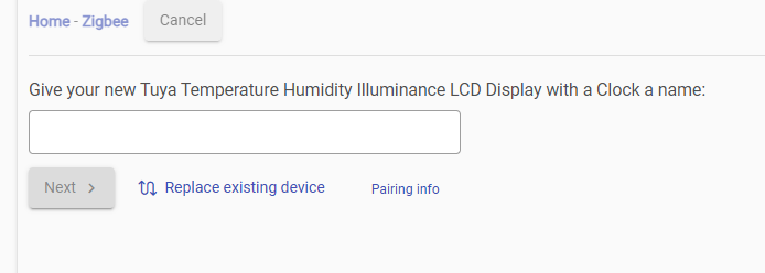

Again it's found line Temp sensor
I'll change drivers now and do advanced settings.
Let you know
Again sleepy device: :frowning:
Did everything what you advised yesterday and today...
