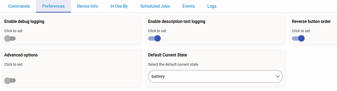

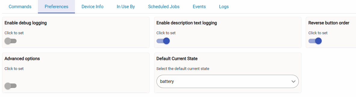

That looks like the @kkossev community driver, did you change the driver after pairing?

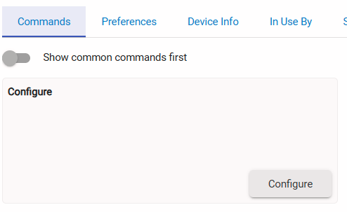

Did you press configure on the command page after changing the driver? Is it in the list of devices under Zigbee Details?
Generally, I have been repairing after each "Driver Code" change and also clicking the "Configure" command. I have mainly been using the "Apps" "Hubitat Package Manager" to install "Tuya Scene Switch TS004F". Also tried enabling the Manager's "Pre-releases option".
Under "Settings" "Zigbee Details" both device do show.
When a button is pressed, nothing show up in the "Live Log".
Shouldn't something show up in the "Live Log" when a button is pressed regardless if it is not what can be processed?

Hi George, First off when posting a huge log, try to use Hide Details to avoid endless scrolling. It's under the settings wheel "Hide Details"
Your device is in fact identified in the driver fingerprint, so it should work. Try pairing the device very close to the hub, if you can.
Sorry about the detail spam.
There is a lot I need to understand. For example:
What does "Configure" do?
What does "Refresh" do?
When I select "Add Device" / "Zigbee", there are 2 link options listed:
a. Pair while trying to avoid Zigbee 3.0 repeaters
b. Pair while exchanging keys in clear
I've tried both of these with No-Joy. My "C-8 Pro" is very close to where I sit, just below the basement floor. As another test I moved the "C-8 Pro" next to the device, which also did not work.
During pairing, after selecting the device and naming, it takes about 2 minutes for the device to come out of paring (LED keeps blinking for 2 minutes).
I have been testing 2 devices. Both have the same behavior.
Hey no worries, I only know because I did the same thing.
I didn't have a problem pairing my Tuya 4 button scene controller. You can try the Double Luck trick, might help. Also remove the battery from the Tuya device for a minute before pairing
also .. you may want to try new batteries .. they can be kind of picky.
when ever you change the driver .. you need to hit the configure button the the device settings page.

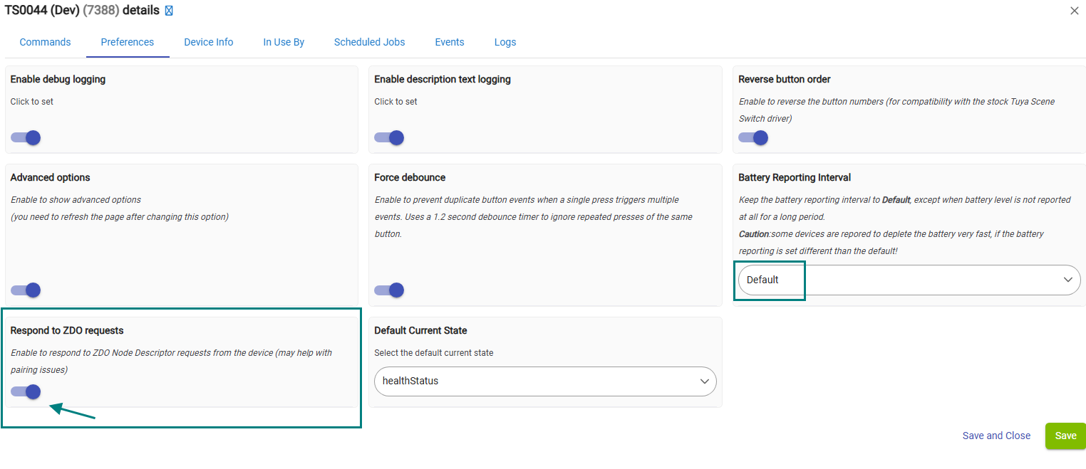

This device is very problematic to pair with HE...
Make sure you are on the latest version of the custom TS004F driver.
Then, enable the 'Advanced options', refresh the Preferences tab and toggle the 'Respond to ZDO requests' option ON :
Save the preferences.
Then, obligatory, use the Double Luck Voodoo to pair the device again to your C-8 hub (do NOT remove the device).
If the pairing process is successful, the flashing scene switch LEDs should start flickering quickly after a few seconds and then the four LEDs should turn off.
The batteries are fine. I have extra 12VDC batteries and have checked their voltages.
The 'Double Luck voodoo' procedure worked.
I had to do it for each switch.

Can you please explain what the "Configure" and "Refresh" command accomplish?
Well, really, it's only when you change drivers that you need to use that.
