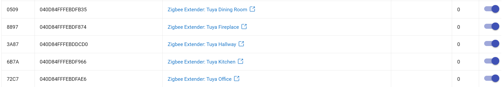

I have quite a few of those Tuya LoraTap Zigbee Extenders, but ever since March 30, 2025, these have now been appearing "Offline". I use the Zigbee Monitor Driver with these.
I tried Resetting them by following the instructions on the Hub Device Page:
They are not receiving messages in the Zigbee Details page:
The Zigbee Map is also no longer showing them.
Has these happened to anyone before? Do I need to use a different driver for these now? Does anyone have a recommendation?

Yeah, I basically just had to repair all of them. It wasn't the driver. I'm using the same driver still and it's working great. Kind of a pain in the butt because I have to freak out the Zigbee network by turning off the hub for 20-30 minutes, so it would re-establish more optimized routing patterns again. It's just weird that ALL of them fell off on the same day. I understand one or two randomly falling off.... but all is just weird. Almost as if there was probably hub update that killed them or something.
The Zigbee Monitor Driver just reads the information from the Repeater and lets you see what it is doing. It is not involved in the actual routing of Zigbee messages, that happens at the Zigbee stack level (hardware).
The fact that both the Monitor Driver and the Hub agree that you are not seeing any messages indicates they are not functioning. I would do as someone else suggested and power cycle one or more of these devices to test. It sounds like they might have hung up, probably a firmware bug IMO. If they start working again you can use the Offline status to monitor in future.
