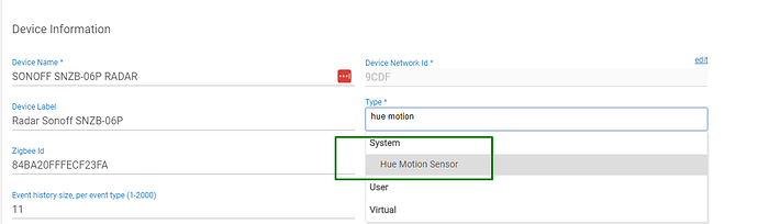

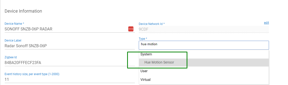

Thank you Mike! It works with the Hue driver!
@junk7001 you can try now with the HE inbuilt driver :
It works as well!
Wow, thanks I'll give it a try.

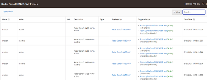

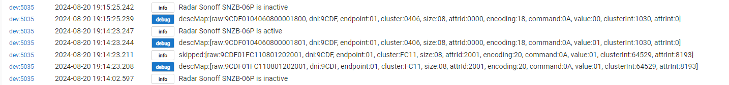

Ok, it seems the motion works after being off for the night. Works from start at 5am and looks like till 9:30am. Then just shows active. Pressing set preferences and refresh bring it back for a while.
The funny part is it stays working again around 9 pm. I have 2 rules setup with the parset at 12 & 4pm.
Did you try using this or the Hue Motion Sensor drivers? Although, i suppose there will be no difference in regards to the motion staying active for a long time.
