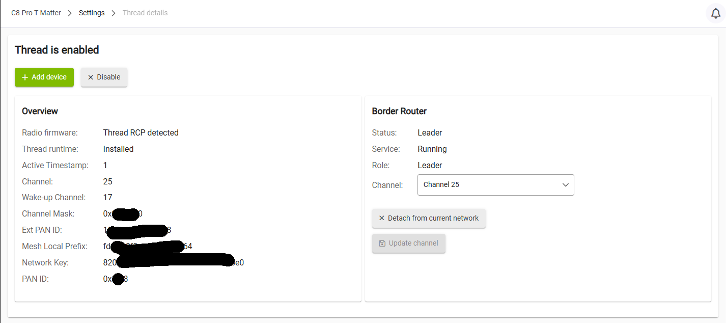

After connecting to the hub, I navigated to the Settings|Thread Details page and added from there
Yes, doing it that way will ensure the C8 Pro T hub's Thread radio is used to commision/pair the MoT device, as you're using the hub's web interface, not the mobile phone app.
You can also bring up the Hub's web user interface in a web browser (i.e. do NOT use the Hubitat Mobile Phone App!) on your phone, and then perform Matter pairing from the same hub web UI. The nice thing about doing this is that it allows you to use your phone's camera to scan the Matter QR pairing code on the physical device, instead of having to type in the code.
