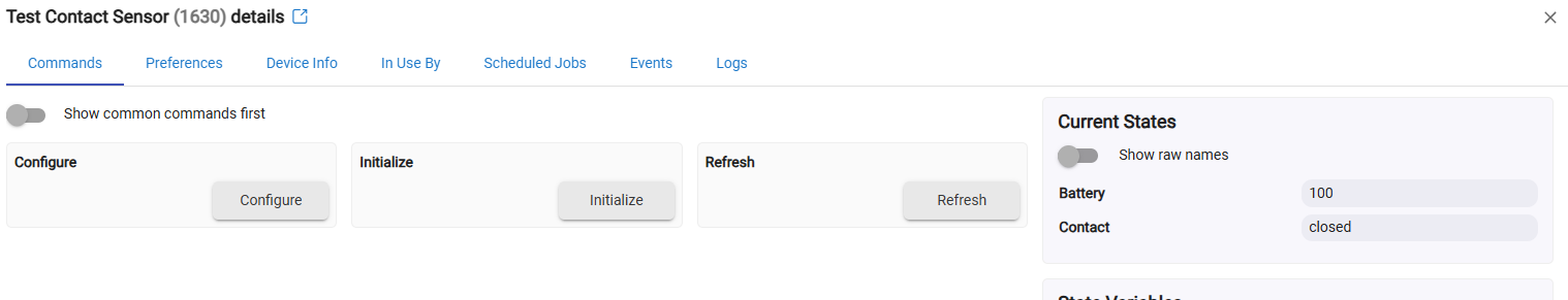

Ok please folks let me be blunt, every time I hear someone say Hubitat is hard to work with I am going to blow my top. Hubitat is a walk in the park compared to what had to do to pair the Matter/Thread Aquara P2 to Home Assistant and share it with Hubitat. Buried in their forms is a little know secret that the app doesn't have the credentials to the Thread Border Router until you "sync" them and it's buried quite deep in system settings. Here is my write up on things I had to do to get the device paired:
6.
Step 1: Thread Border Router Setup
  • SLZB-07p7 detected as /dev/ttyUSB0 :white_check_mark:
  • Thread integration showing network ha-thread-5cbb :white_check_mark:
Step 2: Sync Thread Credentials (Critical Step!)
In Home Assistant Android app:
  1. Settings → Companion App → Troubleshooting
  2. Select "Sync Thread Credentials"
  3. This downloads the Thread network credentials to your phone
Step 3: Now You Can Commission Matter Devices
With Thread credentials synced to your phone:
  1. Add Matter integration in Home Assistant
  2. Use the phone app to scan QR codes and commission Matter devices
  3. The phone can now add devices to your Thread network
Step 4: Get share code code from Home Assistant and Add to Hubitat
  1. Go to devices in Devices and Services in the app
  2. Select the newly added device
  3. Select share and it will go into pairing mode and genereate a bar code and number
  4. Copy the number
  5. In Hubitat add device and select matter
  6. Put in code from Home Assistant and patiently wait
  7. Finalize by giving device name and room
This is my end result! :open_mouth:
