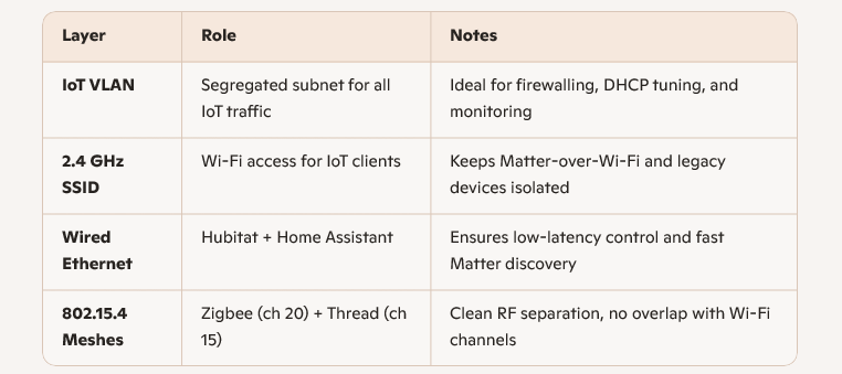

Here is the architecture I am thinking of,
[Thread Device]
[SLZB-07p7 Dongle in Thread Mode]
[Home Assistant VM]
├─ OpenThread Border Router (manages Thread mesh)
└─ Matter Server (exposes Thread devices via Matter)
[Hubitat C-8]
| Thread Device(s) |<----->| SLZB-07p7 (Thread Mode) |<----->| Home Assistant VM |
+------------------+        +------------------------+       |  ├─ Thread Router |
                                                             |  └─ Matter Server |
                                                             |   Hubitat C-8    |
                                                             | (Matter Controller)|
Google could likely confirm this for me, but I'd be grateful to instead hear from Thread gurus here in the community...
