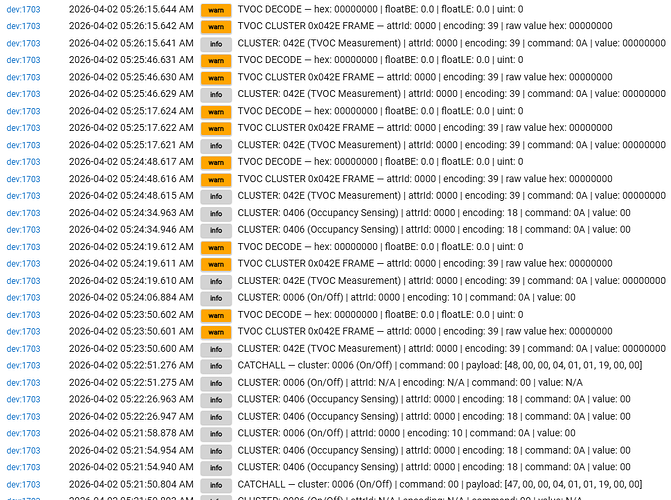

I wrote a small "dump" driver for the values being sent by the sensors. Confirmed that every payload for air quality is zero payload 0x042E:
THIRDREALITY replied to my support ticket stating that I need to wait for the "official" driver. Just sent them this log.

same on mine weird it works for awhile them simply craps out
Yes I have have had it "wake up" report a couple of times and the zero's again. Either it's a firmware bug or they have a real hardware issue on this device. I just returned my device to Amazon. I get the feeling the first batch may not be fully baked.
