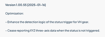

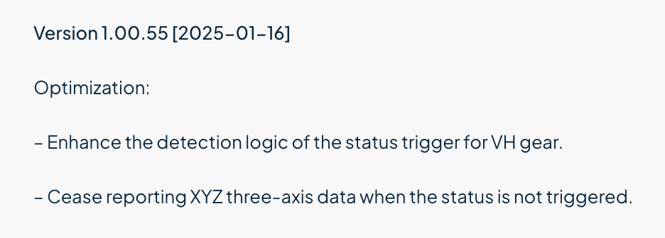

55 is latest available, but as I think others have already confirmed here, this crazy-high message count issue is still present on 55 too.
The 55 release notes seem to come tantalizingly within the neighborhood of this issue (some of that language seems to line up with the chatty cluster Krassimr mentioned), but we'd all obviously like to see this issue addressed when the device is in Active state too.

@mike.maxwell @mike.maxwell @ThirdReality I can confirm I experience the same issue on firmware level 55. I updated the device to this level and had the same experience.
