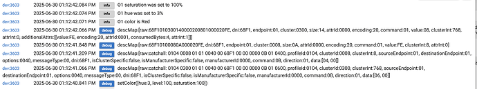

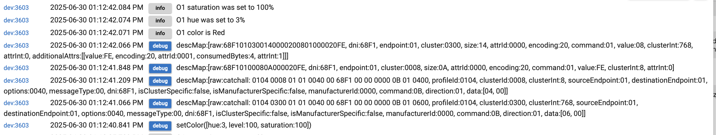

If you enable debug logging, that driver should log the actual values that get passed to the Hubitat commands (from Apple Home or anywhere). I'd start by seeing what those values are when you set the device to red the way that doesn't work as you expect.
Good call. It definitely is not sending hue 0 saturation 100 to make it red. It's sending hue 3 so it seems like a driver issue. No?
