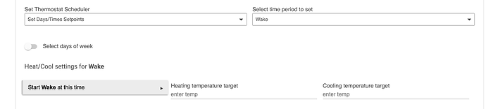

Changing the Period setpoint from the rule, is mandatory to insert also the time for this period, otherwise you get many error.
Is it possible to separate it and only set the temperatures?
I ask this because if i change the period time in the scheduler but i forgot to doit in the rule, the rule overvrite it.
You can just leave the time not set in the rule that sets the temperatures. The Thermostat Scheduler will only change the setpoints, not the time. Below, where it shows Start Wake at this time, just don't set that.
