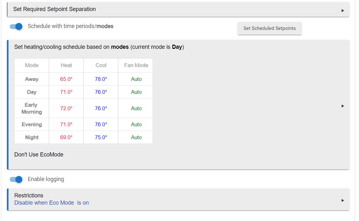

Why do you need to set HOLD? Wouldn't you just have different temps for EcoMode? I have the following for when doors are left open and then subsequently closed. This is for a Honeywell thermostat that needs the cloud to change.
Dunno if that helps or not. I know it doesn't address your specific issue but maybe just setting it up a bit differently will work for you. I do know I had to fight with it a bit to get it to finally work the way I wanted but it seems rock solid for me now.

I have a virtual switch called Eco Mode that, if you look at the rule I posted earlier, gets turned on and off as needed. Then on the Thermostat app there is a restriction to disable when that switch is on.
