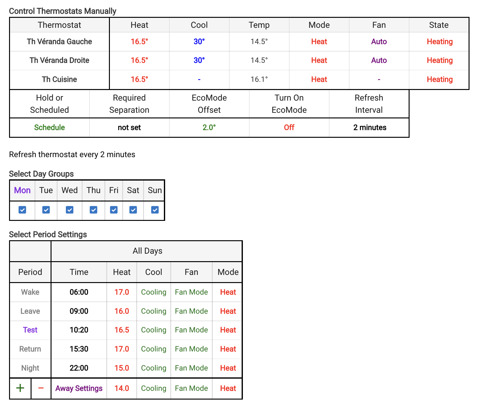

Hi,
Trying to understand the behaviour of Thermostat Scheduler when the hub mode is changed.
I see that the scheduler does respond to a mode change to "Away", but then it appears to resume its normal schedule at the next schedule event.
(the Test schedule event I added just to double check the behaviour was observing).
Note that it's not 100% clear to me what happens when the hub mode leaves Away (I only have two modes at the moment : Away and Home). Does it apply the scheduled temp values for the active time period, or wait for the next scheduled setpoints?
I'm on 2.3.4.123
Cheers

Thanks for your answer.
I double-checked and I don't see anything interfering. In the logs, you can see the Thermostat Scheduler itself is pushing a schedule after reacting on its own to the hub mode change to "Away". The only thing I can think of is that the thermostats are exposed to the HomeKit integration. I'll take them out to see if that makes a difference.
Forgot to mention but I configured this scheduler to schedule using time periods, not modes.

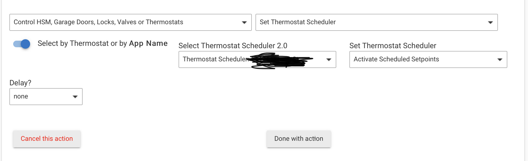

That's what I did, I added a call to Activate Scheduled Setpoints when returning from Away and that works.
The problem now is that when the mode is changing TO Away, the Thermostat Scheduler restriction seems to happen first (scheduler does not apply Away setpoints) and a call to Activate Scheduled Setpoints fails (I get the "restricted by Away mode" log message).

If I don't add the hold, I get this (added a scheduled setpoint at 14:34 just for this test...)

This is the workaround I am currently using. You can create a rule in Rule Machine to do this (I think a Basic Rule might even work) :
Looks like this for me when mode changes to Away. The delay is only there in case there could be any race condition between the Thermostat Scheduler applying the Away setting and this rule applying a Hold.
